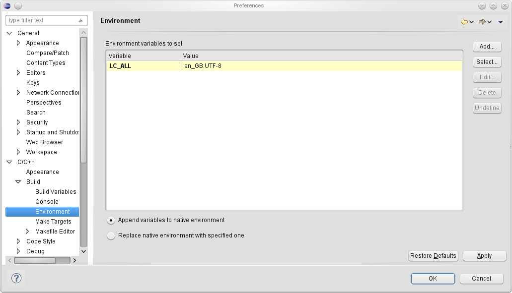

Re: Re: CDT-Helios error reporting [message #733477 is a reply to message #732187] Tue, 04 October 2011 16:44 Go to previous messageGo to next message
Did you add it correctly? Does the variable show up when you open Project Properties->C/C++Build->Environment?
Yes, it shows up, see the attached image.
Would it help to install openSuse11.3 in English instead of German?
(it's a big issue to reinstall it)
Re: Re: CDT-Helios error reporting [message #733582 is a reply to message #733477] Wed, 05 October 2011 02:44 Go to previous messageGo to next message
Nick Schweyer wrote on Tue, 04 October 2011 22:44
That's the global Preferences page (OK, you entered it correctly). I was asking about Project Properties->C/C++Build->Environment of your project.
