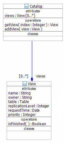

Hello Pradeep,
In general, the diamond symbol presents and location depends on the
corresponding propertie's aggregation value (Property#getAggregation()).
In prinicple it is possible to see the link with diamonds for _both_ ends,
in case if the aggregation value for both of property ends is COMPOSITE.
In particular, I believe that in your model, there are 3 properties that
make sense
1. Catalog::views that is NOT actually part of the association (in properties
view, it does NOT have any association set)
2. Association::views : View, aggregation = COMPOSITE, that is show as link
source with diamond decoration.
3. Association::<unnamed> : Catalog, aggregation = NONE, that is shown as
link target
I am almost sure that (1) is not related to the association, because we EXPLICITLY
FILTERING
properties that are parts of binary associations from being shown in attributes
compartment.
Please check your model resource, and provide me with actual model data in
case I am wrong here.
Also please note that we have recently implemented the set of actions (#182749)
that helps to tranfsorm
single or paired set of class properties typed by different classifiers into
the association between them.
I believe that it will simplify the creation of the sample picture attached
avoiding possible confusion with Catalog::views and Association::views.
Does it make sense?
Michael
> In the following case, a catalog has one or more views. I am just
> wondering whether the diamond symbol is correctly placed. I think it
> should be with the Catalog.
> Thanks
> Pradeep

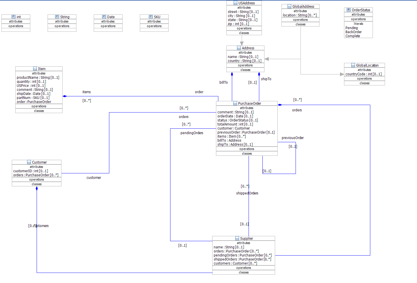

Pradeep Messages: 61 Registered: July 2009 |
Member |
Hi Michael,
Thanks for the explanation. I think I should study more about associations.
I am still quite confused.
I attached the purchase order diagram that is generated using the editor.
Please find it attached.
The original one is available at the following URL.
http://www.eclipse.org/modeling/mdt/uml2/docs/articles/Getti ng_Started_with_UML2/article.html
If you compare these two diagrams, the diamond shapes are positioned exactly
in the reverse order. I am not sure which one is correct now.
Pradeep

One more observation,
In the generated diagram, attributes are placed on both association links
and inside the respective classes.
But in the diagram on the webpage, we see attributes only on the links which
I think is less redundant.
Pradeep

Hello Pradeep,
Thank you for persistence in convinicing me, I see that I was wrong claiming
this as implemented correctly.
Just reporoduced the issue, submitted bugzillas #185045 and #185046.
Michael

Re: diamod direction in case of association [message #470267 is a reply to message #470249] |
Wed, 02 May 2007 22:13 |
Member |
"Michael Golubev" <michael.golubev@borland.com> wrote in message
news:80ef4340aa3f8c95ac2a94927c8@news.eclipse.org...
> Hello Pradeep,
> claiming this as implemented correctly.
> Regards, Michael
>> links
>> which
>> Pradeep
>> "Pradeep" <pradeep@live.com> wrote in message
>> news:f16lg1$hq7$1@build.eclipse.org...
>>> Hi Michael,
>>> associations. I am still quite confused.
>>> editor.
>>> exactly in the reverse order. I am not sure which one is correct now.
>>> Pradeep
>>> news:80ef4340a5c18c9593dde7dba0c@news.eclipse.org...
>>>> Hello Pradeep,
>>>> ends,
>>>> COMPOSITE.
>>>> that make sense
>>>> properties
>>>> as
>>>> link
>>>>> it should be with the Catalog.
>>>>> Thanks
>>>>> Pradeep
Re: diamod direction in case of association [message #588811 is a reply to message #470227] |
Mon, 30 April 2007 10:54 |
Michael Golubev Messages: 383 Registered: July 2009 |
Senior Member |
Hello Pradeep,
make sense
link target
FILTERING
compartment.
Does it make sense?
Michael

Re: diamod direction in case of association [message #588868 is a reply to message #470229] |
Tue, 01 May 2007 06:07 |
Member |
Hi Michael,
Pradeep

Re: diamod direction in case of association [message #588914 is a reply to message #470239] |
Tue, 01 May 2007 07:01 |
Member |
Pradeep

Re: diamod direction in case of association [message #588935 is a reply to message #470245] |
Wed, 02 May 2007 09:17 |
Senior Member |
Hello Pradeep,
Michael
>>>> Thanks
>>>> Pradeep
> Hello Pradeep,
> Regards, Michael
>> links
>> which
>> Pradeep

>>> Hi Michael,
>>> editor.
>>> Pradeep
>>>> Hello Pradeep,
>>>> ends,
>>>> COMPOSITE.
>>>> that make sense
>>>> properties
>>>> as
>>>> link
>>>> shown as
>>>> link target
>>>> we
>>>> EXPLICITLY
>>>> FILTERING
>>>> attributes
>>>> compartment.
>>>> data
>>>> in
>>>> actions
>>>> (#182749)
>>>> classifiers
>>>> into
>>>> attached
>>>> Association::views.
>>>> Does it make sense?
