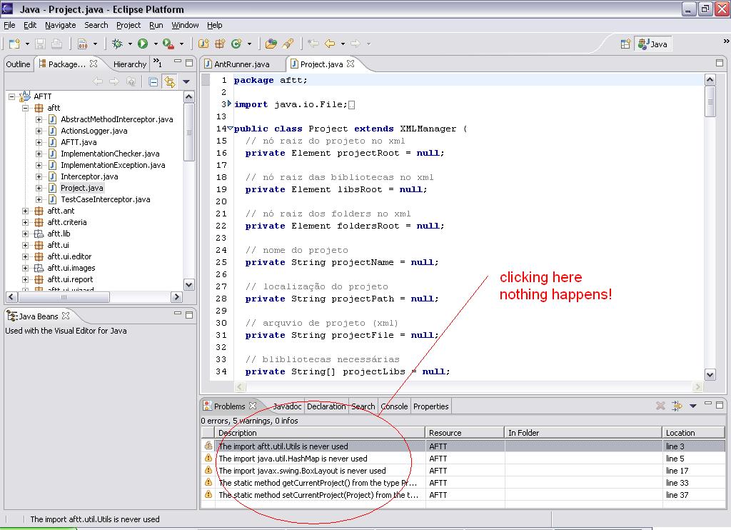

I've moved to Eclipse 3.0.0 (Build id: 200406251208) and i'm experiencing a
new problem...
When I click in a problem/warning listed in the task view I don't go to the
correspondig line/file. How to fix it?
Thanks!

I'm working with Eclipse 3.0.0 and AJDT 1.1.12. The warnings are normal java
warnings (please see attached file) and when I double click nothing happens.
Is it a Eclipse 3.0.0 normal behavior? how can I change it?

Re: Eclipse 3.0.0 & task view [message #40252 is a reply to message #40229] Mon, 16 August 2004 06:04 Go to previous messageGo to next message
Thanks for the extra information. This problem has been encountered before
(see bug 70913 https://bugs.eclipse.org/bugs/show_bug.cgi?id=70913) although
we have been unable to track down its cause. The solution for the time
being is to delete your workspace and start again with a clean one. Could
you possibly let us know if you are running any other plug-ins alongside
AJDT to help us track this down?
Sian
