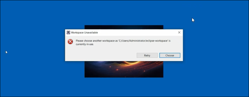

I have a Horizon VDI environment using Windows Server RDS. Users log in to the RDS server with VDI.
The problem is: When users open exclipse on the RDS server, they get the "exclipse-wrokspace" error, because I left it on the server with an administrator account.
How can I install Exclipse for multiple users?

  • Attachment: eclipse1.png

Probably you can just edit the file <installation-location>/configuration/.settings/org.eclipse.ui.ide.prefs to remove the value of RECENT_WORKSPACES from that properties file.
