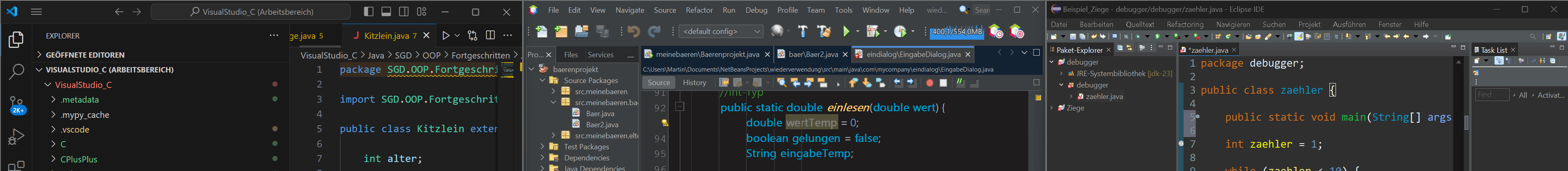

I am new here and I started to use Eclipse IDE for Java Developers because I need it for my education. I tried the search here, but there comes an error 403... . Thats one reason why I start this topic... .
Normaly I use Microsoft Visual Studio Code cause it offers much benefits for user friendly coding experience.
But I recognised that Eclipse shows better information about packges, projects ands so on and I like the overview about the project (I am a Java-beginner).
There is only one thing that is realy anyoing with Eclipse:
Where is your high-resultion / 4K support???
Yes I know that is possible to change the eclipse.ini with the following parameters to get bigger symbols:
-Dswt.enable.autoScale=true
-Dswt.autoScale=150
-Dswt.autoScale.method=nearest
but we are living in the year 2024, my monitor (4k and 40") is from 2015 and your are still working with this smal symbol-size and I need to change manualy that size? What the hell...
Its time to go forward! Even Netbeans IDE 23 uses bigger symbols... .
Take a look on the picture to compare.

There's much work being done in SWT to improve HDPI support on Windows. So you might ask here for what's best to try currently:
https://github.com/eclipse-platform/eclipse.platform.swt
I have 3 different 4k monitors of different physical sizes. Currently I find the best approach is change the properties of java.exe/javaw.exe on the Compatibility tab Change high DPI settings and use High DPI scaling override to be System.
