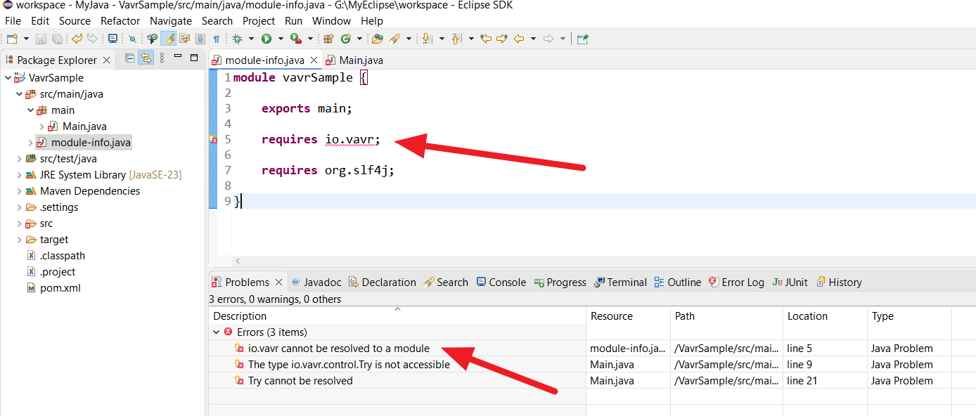

When I try to use it in module-info.java (requires io.vavr;) I get "io.vavr cannot be resolved to a module"
index.php/fa/45309/0/

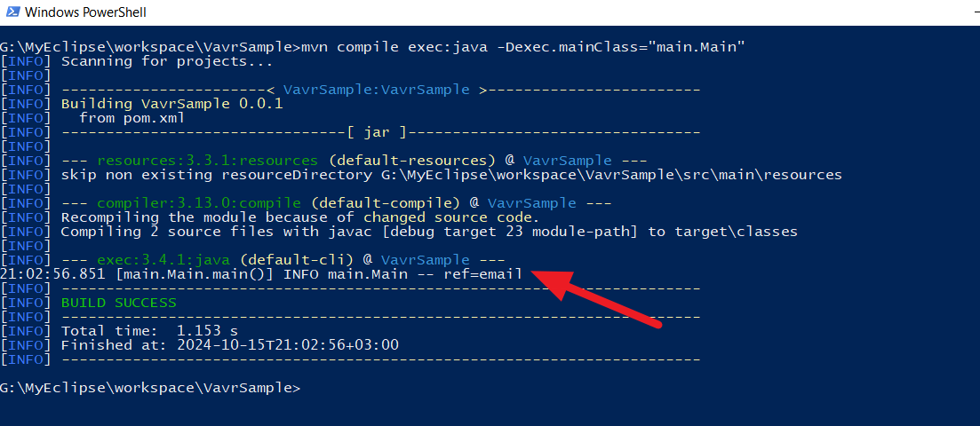

However, using Maven, I can compile the code and also run it successfully.
index.php/fa/45312/0/

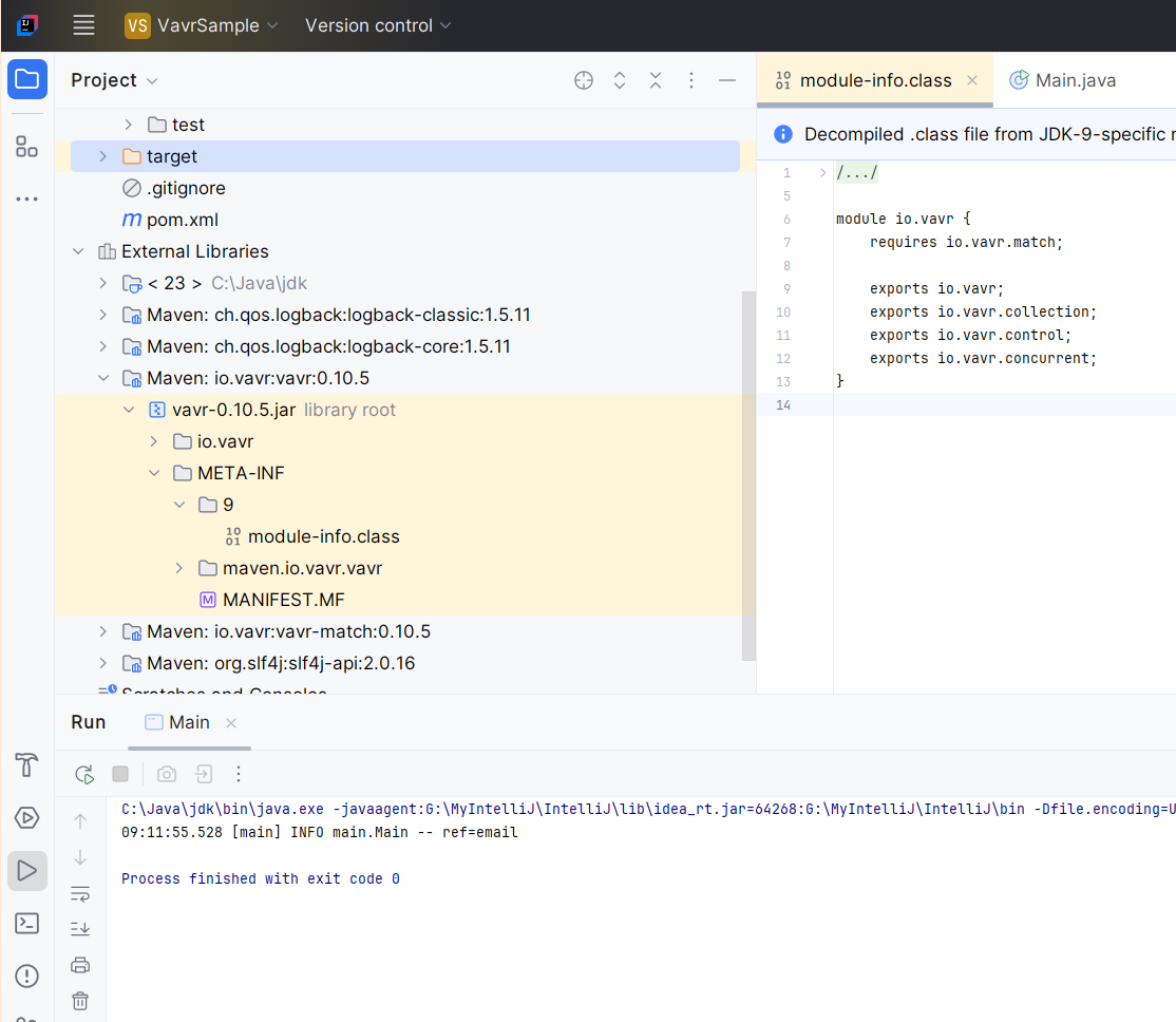

I try using IntelliJ IDEA Community Edition.
io.vavr:vavr:0.10.5 jar is parsed with no problem.
Seems like Eclipse issue
