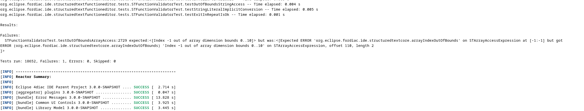

Any help to solve the error would be appreciated.
Log attached.
Build with oracle java 21.0.4 2024-07-16 LTS and maven 3.9.0
[Updated on: Sun, 15 September 2024 16:55]
Re: unable to build 4diac-IDE [develop] with maven [message #1871097 is a reply to message #1871085] Sun, 15 September 2024 19:23 Go to previous message
Alois Zoitl is currently offline Alois ZoitlFriend
Messages: 1638
Registered: January 2014
It seems you found a bug in our tests where a part of our code was locale specific but shouldn't have been. Should be fixed with https://github.com/eclipse-4diac/4diac-ide/pull/491
Thx to Martin for fixing and thx to you for finding and reporting!
