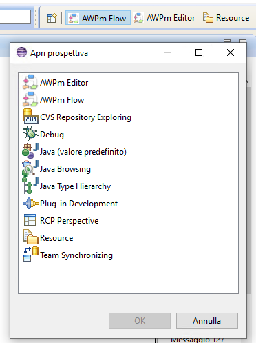

I was in the need of developing an application to build up a block diagram flow chart to perform specific task in the given depicted order, my first thought is on developing the whole with the GEF and EMF.
The develop phase is quite simple, now I'm struggling on removing the perspective that came with the framework as shown below
index.php/fa/45099/0/
What I've tried is:

PS: Until now I get to not show a given perspective on the right of the "Open Perspective" button with a few lines of code in the start of the Application
IPerspectiveDescriptor[] descriptors = getWorkbench()
				.getPerspectiveRegistry().getPerspectives();
		PerspectiveRegistry pr = (PerspectiveRegistry) getWorkbench()
				.getPerspectiveRegistry();
		for (IPerspectiveDescriptor iPerspectiveDescriptor : descriptors) {
			if (iPerspectiveDescriptor.getId().equalsIgnoreCase("org.eclipse.debug.ui.DebugPerspective")) {
				pr.deletePerspective(iPerspectiveDescriptor);
but the user can stille be able to open the Debug perspective.
