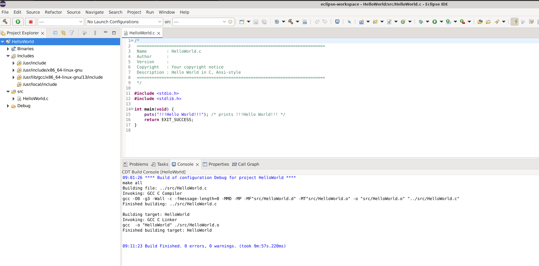

I just install Eclipse CDT 2024-06 on Debian Linux. The installation was OK but when I run a simple HelloWorld C program, it's very slowly and took too long time.

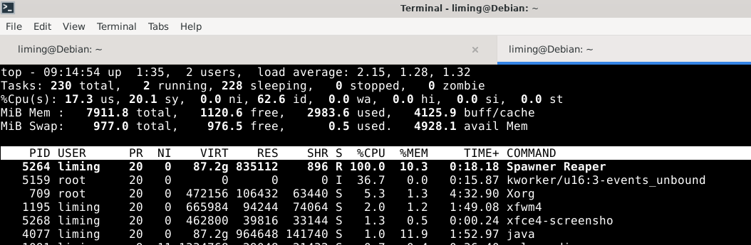

I found process 'Spawner Reaper' used much virtual memory and CPU time. I took below pictures for your reference.

Looks like https://github.com/eclipse-cdt/cdt/issues/835 .
