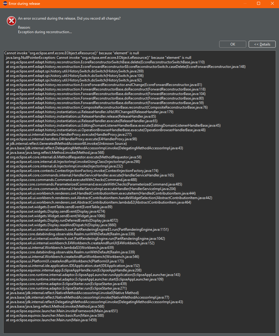

Unfortunately, we occasionally have trouble releasing changes in our Ecore model. The problem is that Eclipse displays an error dialog stating that the release could not be completed.
Here is a screenshot of the problem (see attachments releaserror.png)
When this happens, our only way to solve it is to undo all changes in the history to the point where we can release and then redo the changes one by one. This process is very annoying and tedious.
Currently, there are very few changes to the model. We added a new enum and set a new attribute with this enum as the type for a model class member. That's it.
Unfortunately, I cannot find anything about the error message "An error occurred during the release. Did you record all changes?"
Maybe someone has had the same problem and can help us identify which operation or behavior in our workflow causes this issue.

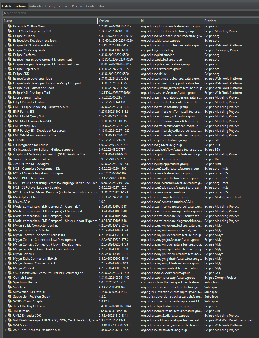

Here is an image of all the installed software in Eclipse see attachments installedSoftware.png

Re: An error occurred during the release [message #1868082 is a reply to message #1868034] Thu, 11 July 2024 03:21 Go to previous messageGo to next message
Is there a way how I can debug the "release" operation for .history files? It would at least help to know what element is null and makes the problems.
