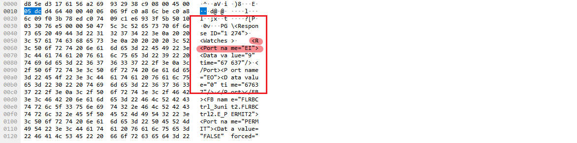

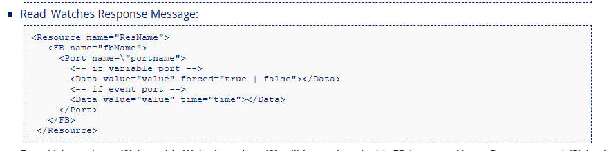

When I was using Wireshare to capture the response of Forte's monitor, I found that the monitor format of Forte's response was incorrect
Normal format is:
index.php/fa/44316/0/
But i receive the reponse message's format is:
index.php/fa/44319/0/
It seems that forte was assembled into the wrong format
The attachments are Wireshark capture file and .fboot file

It can be reproduced. This is a Forte request generated by a simulation tool I developed myself
We can see that in the above deploy.fboot file, there are three identical subprograms: FLRBCtrl_3unit, FLRBCtrl_3unit1, FLRBCtrl_3unit2
When I only execute and monitor the two subroutines FLRBCtrl3unit and FLRBCtrl3unit1, the message returned by Forte is completely normal
When I added the FLRBCtrl3unit2 subprogram, the above problem occurred
Also, what kind of content do I need to provide to help you troubleshoot this issue?
