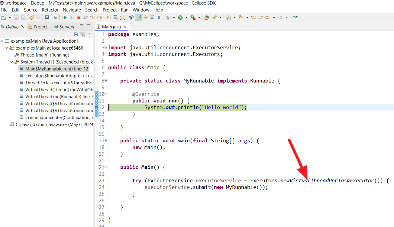

I have a really strange problem with the debugger. When my application uses virtual threads, they do not appear in the thread list of the debug view, but even more strangely, the do not even work when I try to debug the application!
I am not sure I can articulate this problem clearly enough, because from a few days of google searching I am alone with my problem on the internet :)
First of all, I am looking for confirmation that someone is able to debug JDK 21 Virtual Threads in Eclipse (4.31).

Using Version: 2024-03 (4.31)
Java openjdk-22.0.1_windows-x64_bin.zip
Seems to work.
package examples;
import java.util.concurrent.ExecutorService;
import java.util.concurrent.Executors;
public class Main {
	private static class MyRunnable implements Runnable {
		@Override
		public void run() {
			System.out.println("Hello world");
	public static void main(final String[] args) {
		new Main();
	public Main() {
		try (ExecutorService executorService = Executors.newVirtualThreadPerTaskExecutor()) {
			executorService.submit(new MyRunnable());
