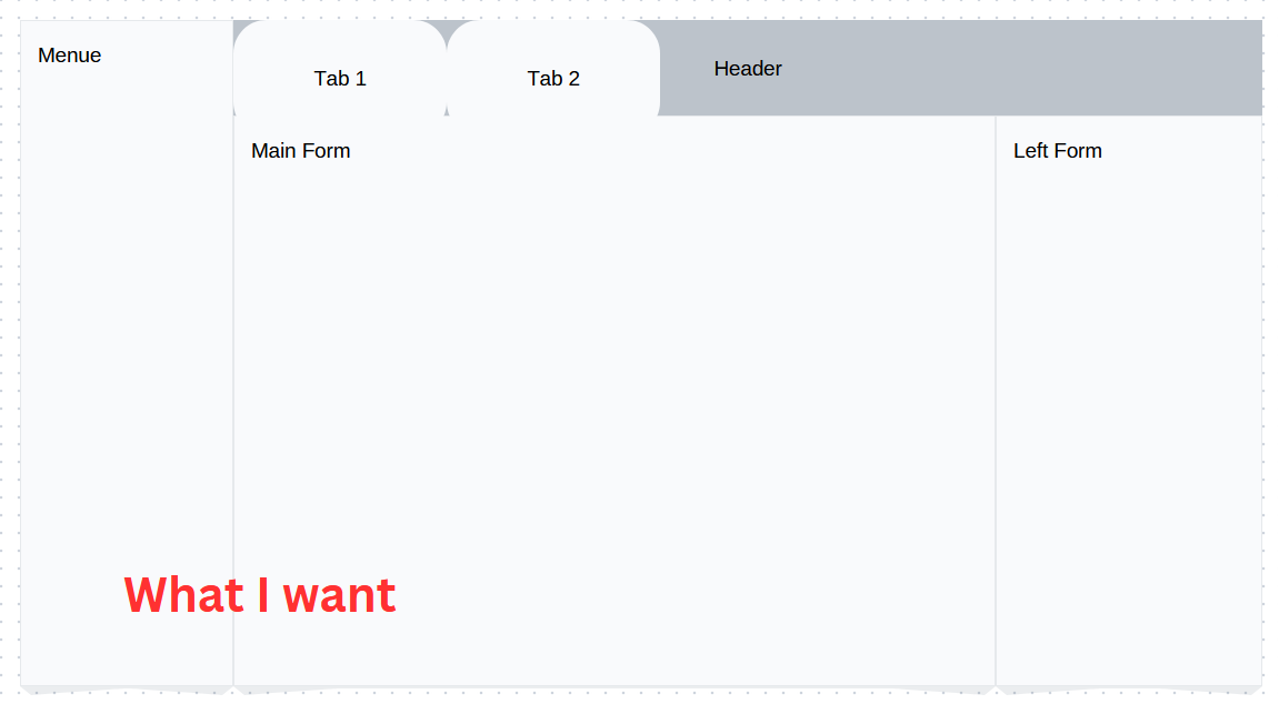

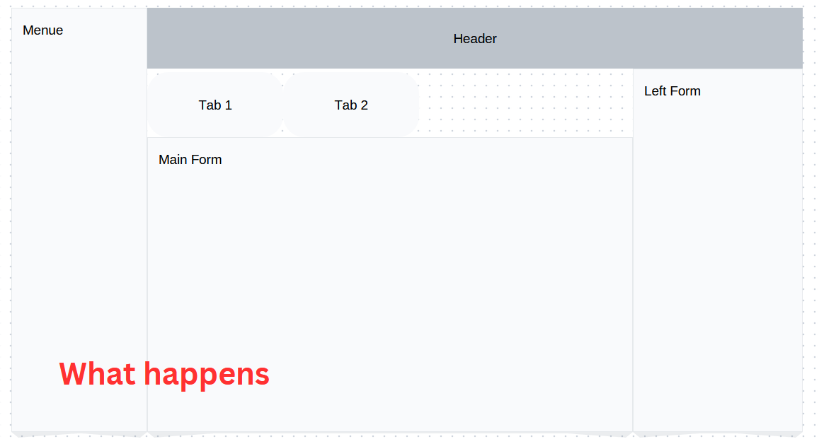

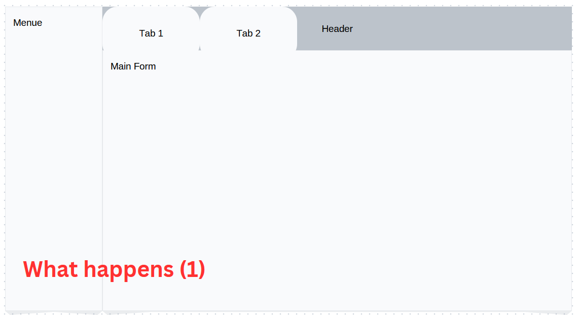

Here a few pictures:

this is expected behavior. I can explain the idea behind it: if you open a form in another area and that form has a tab, its tab area should be on the same level as the tab area on the center area. Your form on the right does not have a tab because it has no title and no icon, so I agree with you it is confusing that the tab area of the center tab box moves down.
There is not a property to disable that behavior. But it should be possible to adjust the behavior by overriding HeaderTabBoxController, as you have already tried according to your other post.
