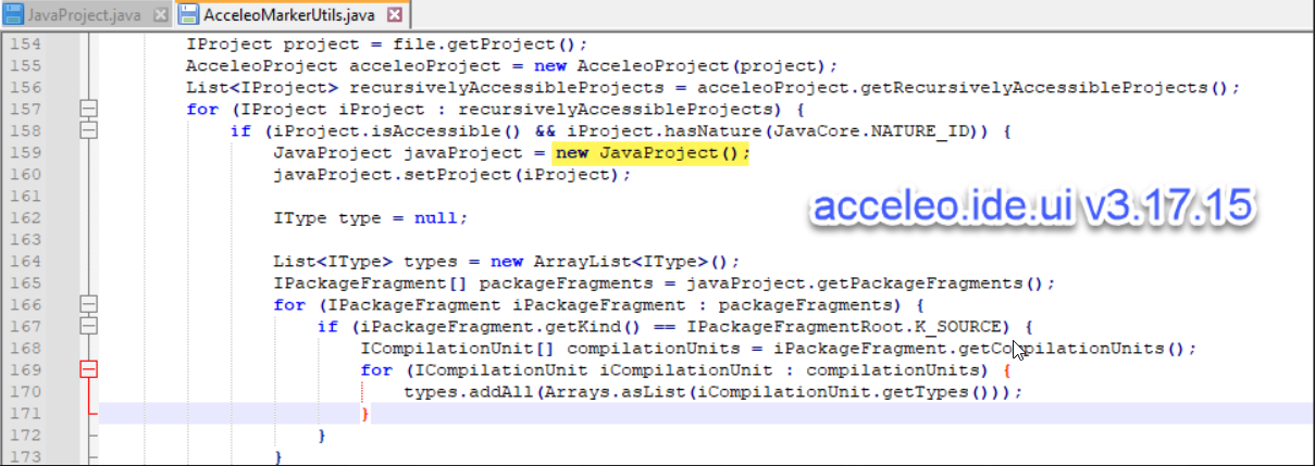

Upon investigation, the issue was caused by outdated code in acceleo.ide.ui v3.7.15.
Acceleo code is instantiating a no-arg constructor in org.eclipse.jdt.internal.core.JavaProject class. However, no-arg constructor no longer exist starting jdt.internal.core v3.37.0 (current release).

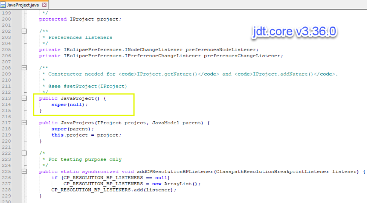

Before:
jdt.internal.core v3.36.0
- No Error in Acceleo

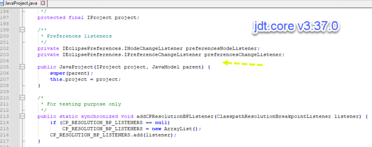

Now:
- Acceleo Error Started
index.php/fa/44169/0/

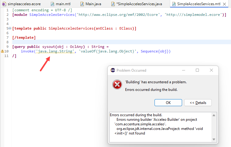

Re: [Acceleo] IDE Error during Acceleo Project Build in Eclipse 202403 [message #1865214 is a reply to message #1864986] Mon, 29 April 2024 03:26 Go to previous messageGo to next message
Analysis:
We found out that the error exist only when Acceleo project have java services template. Errors are not encountered on normal template (No query template):
