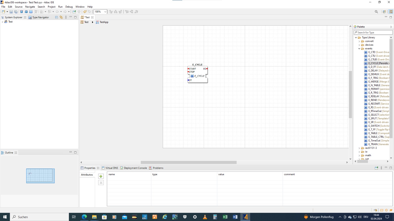

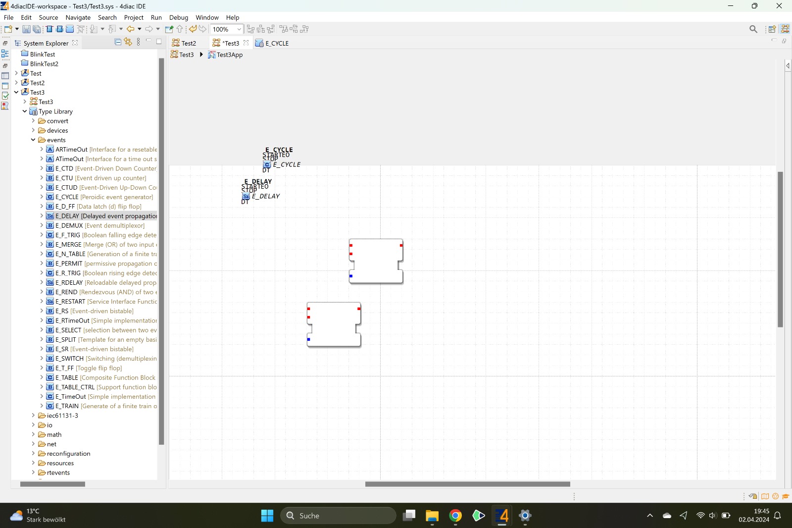

I'm using 4DIAC the first time now. I installed the programm from the website.
After starting the programm my function blocks aren't displayed correctly.
I own a surface book 3 with 32gb ram and an installed version of Windows11.
I tried the programm on the Windows10 computer from my dad and it worked correctly. I'm linking two pictures maybe someone can help me.

Unfortunately we sometimes have troubles with screen resolutions. Especially when native scaling is set. I think it is better in our preview versions. Therefore I would strongly recommend that you use our RC prebuilt versions which you can download from here: https://download.eclipse.org/4diac/updates/rc/
Just scroll down to the download zips.
Re: 4DIAC FBs text have an offset [message #1864682 is a reply to message #1864672] Wed, 03 April 2024 05:39 Go to previous messageGo to next message
with your tip that the problem is caused by the scaling settings I could solve it.
I started 4diac with 100% scaling and then I could reset my settings to 200% scaling.
