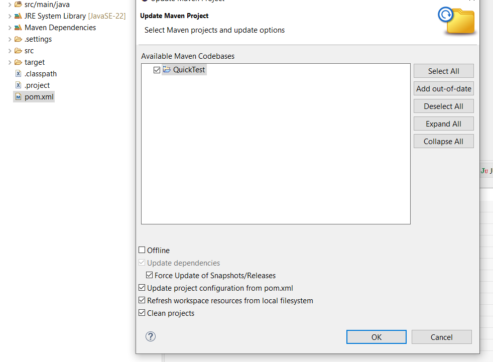

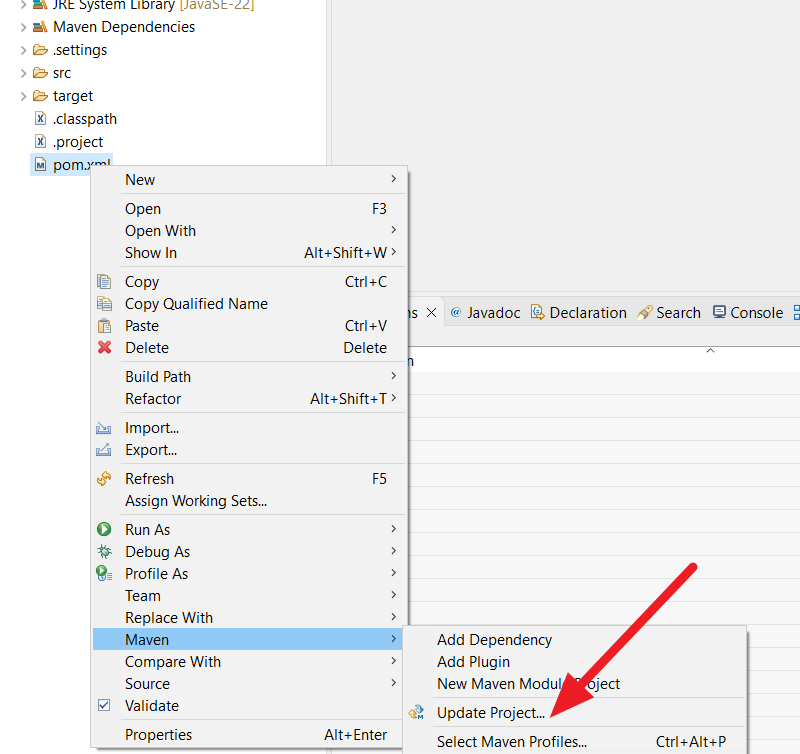

Have you tried to update the project ?
index.php/fa/44084/0/
This will take you to this popup:
index.php/fa/44085/0/
shortcut:
Alt + F5
