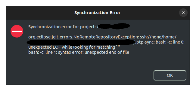

When syncing a "synchronized project" with a remote server. I get the following "unexpected EOF while looking for matching `"bash:-c:line1:syntax error:unexpected end of file.
Please find the attached screenshot.

Re: Synchronization error for project [message #1863856 is a reply to message #1863838] Fri, 01 March 2024 07:00 Go to previous messageGo to next message
That must be a configuration error. Probably the .git/config file is corrupted.

Re: Synchronization error for project [message #1863872 is a reply to message #1863868] Sat, 02 March 2024 11:34 Go to previous message
I found a solution. This happens if the login-shell outputs some "welcome" message. So when you synchronize the project, it retrieves hash info along with the "welcome" message, which interferes with the inbuilt modules. In order to circumvent, you have to suppress this message from the say bash or csh etc.
The solution to avoid these errors is to disable .profile and ~/.bashrc execution in the login shell command:
Preferences->Remote Development->Remote Connections->(Select connection and push "Edit")->Advanced->
Use Login shell: selected
Login shell command: /bin/bash --noprofile --norc -l -c '{0}'
