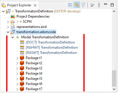

I defined an EMF metamodel (1st Eclipse instance), and a Xtext project for having a textual language for it (2nd Eclipse).
On the 3rd Eclipse, then I:
1. create a modeling project
2. create a textual file with the required extension
3. manually insert the minimum required content to get a parsable model
Issue: in the model explorer, it is not possible to expand it (seeing the contained model elements) unless I close the project and reopen it.
Am I doing something wrong on the Xtext or EMF side? Any way to overcome this?

Tamas Miklossy wrote on Wed, 28 February 2024 09:29
Are you talking about the Modeling Project from Sirius?
Hi Tamás,
yes, it is a Sirius modeling project.
In particular, I am referring to this:
index.php/fa/44016/0/
Sirius also adds stuff in there (the available diagrams), but I actually don't know if Sirius is the main responsible for generating that (I would say, the metamodel.edit/editor plugin is)
  • Attachment: tree.png
    (Size: 14.68KB, Downloaded 158 times)
