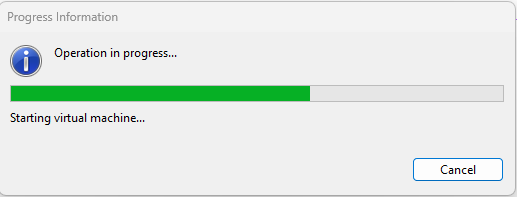

As AUT I would like to use eclipse based IDE which is installed in write only folder. This IDE comes with some pre-installed feature which I updated (through p2) before running AUT. Because it is in write only folder feature update goes into configuration location which is specified in eclipse/configuration/config.ini osgi.configuration.area = <location>.
When I started AUT I noticed that pre-installed plugin is not updated, because AUT did not have specified configuration location. I specified configuration location in AUTs configurations with program argument -configuration <location> and that is when my problem arose.
Running AUT with -configuration argument starts IDE with updated plugin, but RCPTT shows 'Progress Information' (Image below) which times out after few minutes and reports that AUT is no responding although AUT is fully responsive.
index.php/fa/43947/0/
In RCPTTs workspace/.metadata/.plugins/org.eclipse.pde.core/<AUTs name>/console.log is empty file.
In RCPTTs workspace/.metadata/.log is this
!ENTRY org.eclipse.rcptt.launching.ext 1 0 2024-01-29 10:52:42.823
!MESSAGE RCPTT: Launching AUT: <AUTs name>: AUT command line arguments is set to: [-launcher, C:\eclipse-rcptt\rcptt.ide-2.5.5-nightly-win32.win32.x86_64\rcptt\eclipse.exe, -name, Eclipse, -showsplash, 600, -product, org.eclipse.platform.ide, -data, C:\eclipse-rcptt\rcptt.ide-2.5.5-nightly-win32.win32.x86_64\ws/../aut-<AUTs name>, -configuration, file:C:/eclipse-rcptt/rcptt.ide-2.5.5-nightly-win32.win32.x86_64/ws/.metadata/.plugins/org.eclipse.pde.core/<AUTs name>/, -dev, file:C:/eclipse-rcptt/rcptt.ide-2.5.5-nightly-win32.win32.x86_64/ws/.metadata/.plugins/org.eclipse.pde.core/smartcode/dev.properties, -os, win32, -ws, win32, -arch, x86_64, -consoleLog, -configuration, <LOCALAPPDATA>/eclipse/configuration, -eclipse.keyring, C:\eclipse-rcptt\rcptt.ide-2.5.5-nightly-win32.win32.x86_64\ws\.metadata\.plugins\org.eclipse.pde.core\<AUTs name>/secure_storage, -vm, C:\jdk]
