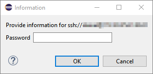

Hello!
Since eclipse 2023-09 / 6.7.0 we have the problem that we have to input the password for each git interaction (see attached image). We are connecting directly with ssh to an own server by ssh+git://, with stored username and password in eclipse. We are not using any ssh dsa/rsa keys.
I tried different settings but can't figure out what to do to fix this. I also tried to configure ssh keys on the system but with no success.
I am not any expert on this, but from the changes I saw it is maybe connected to the change in EGitCredentialsProvider in 6.7.0.?
Any help would be nice since we are not updating to a newer version of eclipse because of this. ;)
Thanks!
Re: ssh password dialog on each git interaction since eclipse 2023-09 [message #1862558 is a reply to message #1862491] Mon, 11 December 2023 15:54 Go to previous messageGo to next message
Looks like you're using password authentication in SSH. Can you please post a stack trace when this dialog is shown?
Re: ssh password dialog on each git interaction since eclipse 2023-09 [message #1862590 is a reply to message #1862558] Tue, 12 December 2023 15:20 Go to previous messageGo to next message
No stacktrace needed anymore. Your analysis is quite right. https://eclipse.gerrithub.io/c/eclipse-egit/egit/+/1173511 should fix this problem. Sorry about that.
I haven't seen any earlier report about this. I guess we don't have many users using SSH with password authentication.
Re: ssh password dialog on each git interaction since eclipse 2023-09 [message #1862647 is a reply to message #1862590] Mon, 18 December 2023 02:56 Go to previous message
Tested with the nightly version - works for me.
Case closed. :)
