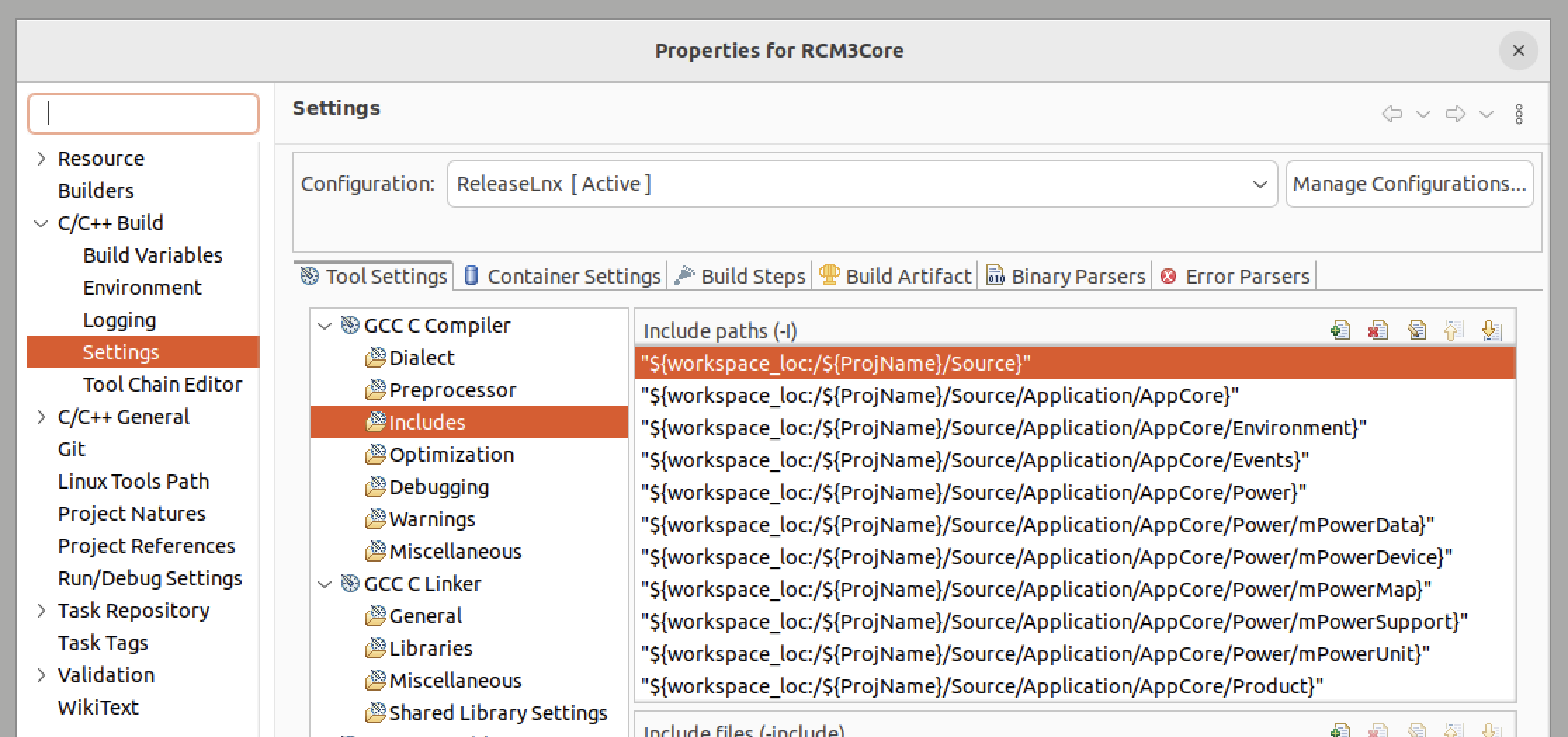

I don't know about includes with the folder paths already in them, but for includes with no paths you have to manually add include paths in the project properties.
Right click the project in Project Explorer. At the bottom of the menu, select Properties.
Then open C/C++ Build > Settings. Select the Tool Settings tab, open GCC C Compiler (assuming that's what you have) and select Includes.
Use the page [+] button to add paths from your project.
I don't know why these can't be scanned (I've used other Eclipsed based tools which automatically included project folders), but the native CDT requires doing this manually.
So, even if you have some folder paths in your #includes, you might need the project root folder, or some others defined this way.
