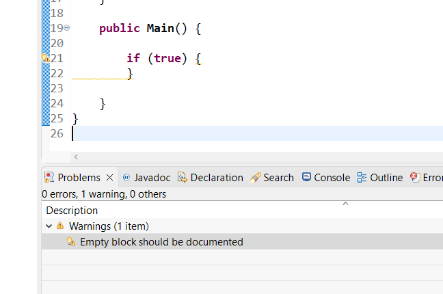

There is a check for "Empty block" but the default is ignore.
When enabled, you get this:
index.php/fa/43513/0/
IMHO, the default for "Potential programming problems" should be at least a warning.
