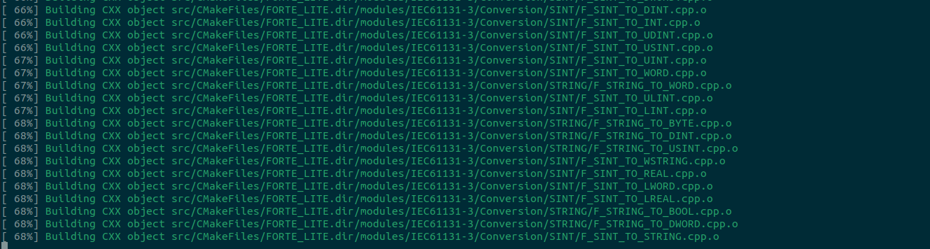

I am new to 4diac and i am trying to compile FORTE for a Raspberry pi 4 with OPC UA, but it keeps crashing.
Compiling for RPI was a success.
However after successfully compile open62541 v1.0 according to tutorial with OPC UA, i have tried to include the extra commands in file setup_posix.sh (file attached).
It creates all cmake files in /bin/posix but after make command it gets stuck forever after some time compiling (screenshot attached). Have already tried on two RPI's 4 (4GB and 8GB). Both have the same results.
What am i doing wrong?
Note: I am using Raspbian OS 64 bits.
Any help would be appreciated.

However after comand "make -j" it starts the compilation process but crashes around 65% to 75% and i have to reset the raspberry pi 4.
I have tried to include the commands inside setup_posix.sh but i get the same error.
Finally i installed cmake-gui and tried to include paths and parameters till i have no red lines. Cmake creates the building files but after "make" command it crashes the same way.

Hmh this is strange and I wouldn't have expected this. I just had a problem with "make -j" of using to much memory on a Windows machine. Reducing the number of threads to 2 or 4 helped there. Could this also be the case?
