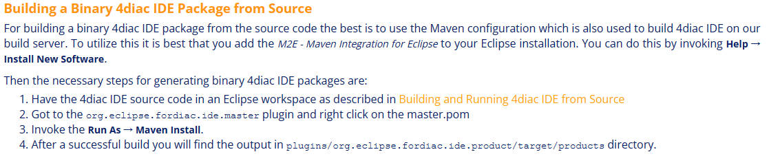

1. Could not find the `org.eclipse.fordiac.ide.master` plugin in the latest repository
On official documents, It say that we need to using the `maven install` to install the master.pom in the `org.eclipse.fordiac.ide.master`, But I couldn't find the master folder in the master branch. Is the official document not updated?
index.php/fa/43187/0/

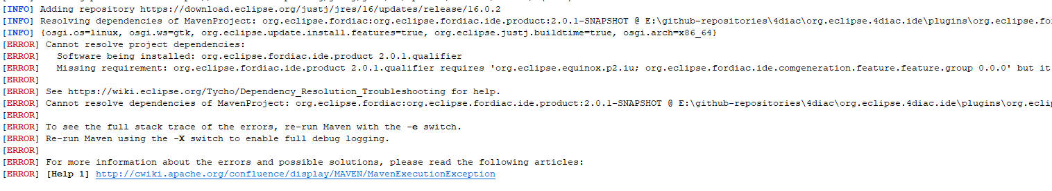

2. When I install in product, it prompts the following error
[INFO] Scanning for projects...
WARNING: A terminally deprecated method in java.lang.System has been called
WARNING: System::setSecurityManager has been called by org.eclipse.osgi.internal.framework.SystemBundleActivator (file:/E:/java-jar/repository/org/eclipse/platform/org.eclipse.osgi/3.16.300/org.eclipse.osgi-3.16.300.jar)
WARNING: Please consider reporting this to the maintainers of org.eclipse.osgi.internal.framework.SystemBundleActivator
WARNING: System::setSecurityManager will be removed in a future release
[INFO] Computing target platform for MavenProject: org.eclipse.fordiac:org.eclipse.fordiac.ide.product:2.0.1-SNAPSHOT @ E:\github-repositories\4diac\org.eclipse.4diac.ide\plugins\org.eclipse.fordiac.ide.product\pom.xml
[WARNING] No system packages found in profile nor toolchain for JRE-1.1, using current JRE system packages.
This can cause faulty dependency resolution, consider adding a definition for a 'jdk' with id=JRE-1.1 in your toolchains.xml
[WARNING] No system packages found in profile nor toolchain for JavaSE-11, using current JRE system packages.
This can cause faulty dependency resolution, consider adding a definition for a 'jdk' with id=JavaSE-11 in your toolchains.xml
[WARNING] No system packages found in profile nor toolchain for JavaSE-15, using current JRE system packages.
This can cause faulty dependency resolution, consider adding a definition for a 'jdk' with id=JavaSE-15 in your toolchains.xml
[WARNING] No system packages found in profile nor toolchain for JavaSE-16, using current JRE system packages.
This can cause faulty dependency resolution, consider adding a definition for a 'jdk' with id=JavaSE-16 in your toolchains.xml
[INFO] Fetching p2.index from https://download.eclipse.org/justj/jres/16/updates/release/16.0.2/ (172B)
[INFO] Adding repository https://download.eclipse.org/justj/jres/16/updates/release/16.0.2
[INFO] Resolving dependencies of MavenProject: org.eclipse.fordiac:org.eclipse.fordiac.ide.product:2.0.1-SNAPSHOT @ E:\github-repositories\4diac\org.eclipse.4diac.ide\plugins\org.eclipse.fordiac.ide.product\pom.xml
[INFO] {osgi.os=linux, osgi.ws=gtk, org.eclipse.update.install.features=true, org.eclipse.justj.buildtime=true, osgi.arch=x86_64}
[ERROR] Cannot resolve project dependencies:
[ERROR]   Software being installed: org.eclipse.fordiac.ide.product 2.0.1.qualifier
[ERROR]   Missing requirement: org.eclipse.fordiac.ide.product 2.0.1.qualifier requires 'org.eclipse.equinox.p2.iu; org.eclipse.fordiac.ide.comgeneration.feature.feature.group 0.0.0' but it could not be found
[ERROR]
[ERROR] See https://wiki.eclipse.org/Tycho/Dependency_Resolution_Troubleshooting for help.
[ERROR] Cannot resolve dependencies of MavenProject: org.eclipse.fordiac:org.eclipse.fordiac.ide.product:2.0.1-SNAPSHOT @ E:\github-repositories\4diac\org.eclipse.4diac.ide\plugins\org.eclipse.fordiac.ide.product\pom.xml: See log for details -> [Help 1]
[ERROR]
[ERROR] To see the full stack trace of the errors, re-run Maven with the -e switch.
[ERROR] Re-run Maven using the -X switch to enable full debug logging.
[ERROR]
[ERROR] For more information about the errors and possible solutions, please read the following articles:
[ERROR] [Help 1]
index.php/fa/43188/0/
Re: Failed to build 4Diac IDE [message #1859147 is a reply to message #1859141] Mon, 15 May 2023 14:27 Go to previous messageGo to next message
Alois Zoitl is currently offline Alois ZoitlFriend
Messages: 1638
Registered: January 2014
ah yes. We removed the master plugin allready some time ago. Just invoke maven install in the root directory of 4diac IDE. There is the pom.xml that you need.
Re: Failed to build 4Diac IDE [message #1859148 is a reply to message #1859147] Mon, 15 May 2023 15:23 Go to previous messageGo to next message
Messages: 1638
Pushed a fix to the documentation: https://git.eclipse.org/r/c/4diac/org.eclipse.4diac.ide/+/201875
Re: Failed to build 4Diac IDE [message #1859251 is a reply to message #1859148] Tue, 23 May 2023 10:05 Go to previous message
ming ming is currently offline ming mingFriend
Messages: 13
Registered: May 2023
Thx, It's normal now
