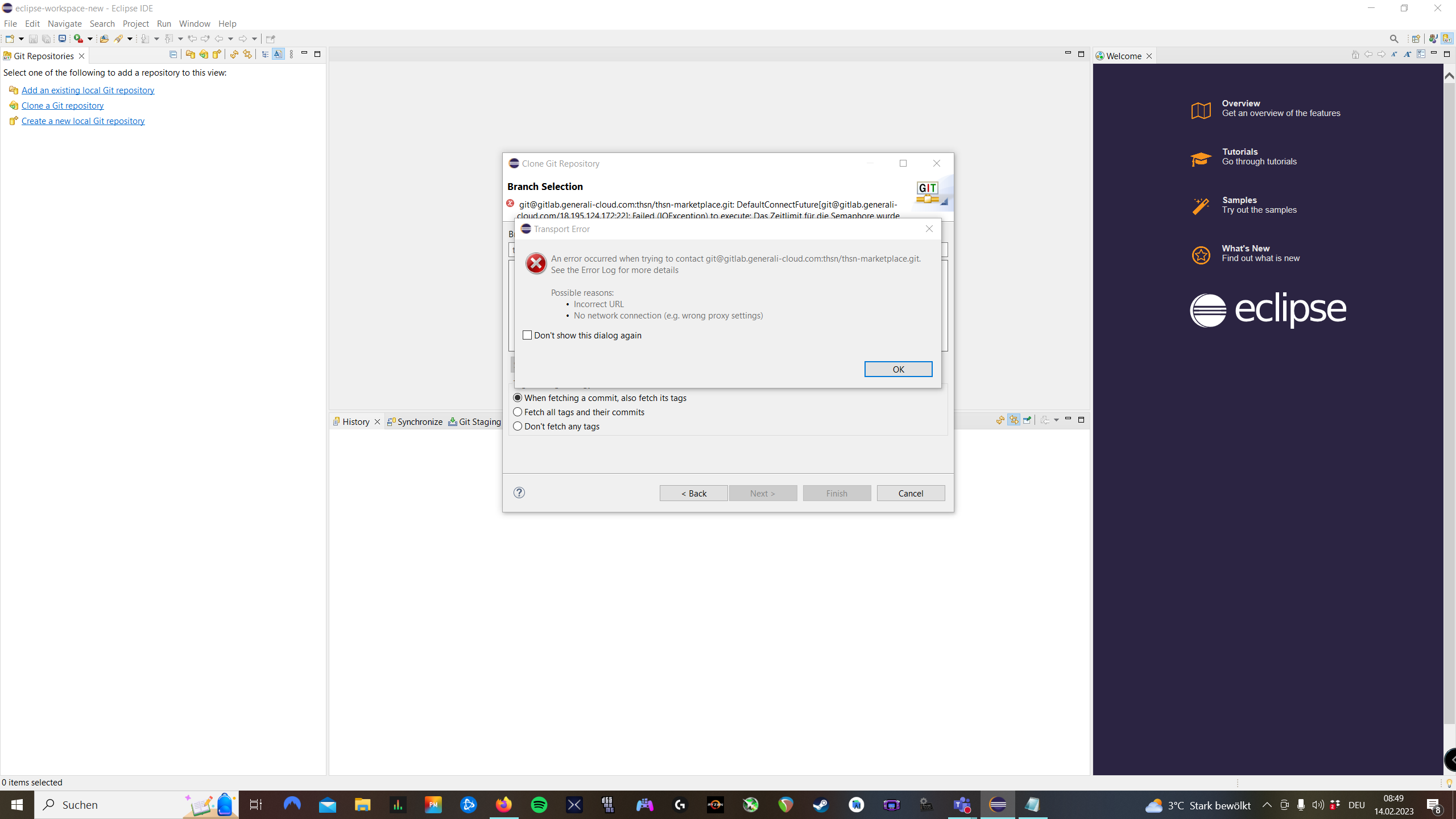

I am having trouble with an error concerning cloning a gitlab repository of a maven project in eclipse.
I attached the error window as a file to this post.
I am on windows 10, the currently newest eclipse version(2022-12) and have updated windows, as well as my drivers.
The actual error message itself reads:
"Failed (IOException) to execute: Semaphore timeout period has expired."
This error happens fairly quickly. I only have to wait about 3 seconds before eclipse tells me the cloning failed. I googled around to look for possible sources of this error, and there were some unanimous conclusions made across several areas in which this error occurs.
1. Firewall or anti-virus. I use no secondary software and have attempted to clone while both windows firewall and antivirus were disabled. No luck.
2. Fragmented drive, large filesize or not enough space. I have over 100gb of free space left on the ssd I am attempting to clone the project to, which itself is below 1gb in size, and ssd's do not fragment the same way hdd's do. My ssd is formatted as NTFS already, which most sources recommend to do. My disk also has no errors or anything similar.
4. Network issue. I have no network connectivity issues. I have attempted to clone the repository from three different networks as well, no luck.
5. Unwanted services being active. I have attempted to clone the repository after doing a "clean boot", ie. disabling all non-windows related services.
6. Hardware issue. I've attempted to clone the repository from different devices (different PC and laptop) as well (although admittedly within my home network), but still no luck. They return the same error.
Could this be a permissions issue? I am at a bit of a loss on what to do here, as I am expected to clone the repository and start work on this project fairly soon, but as my bosses are busy and neither they nor anyone I can find on google seems to have encountered this problem before I don't quite know what to do.
Any advice or further information needed?
