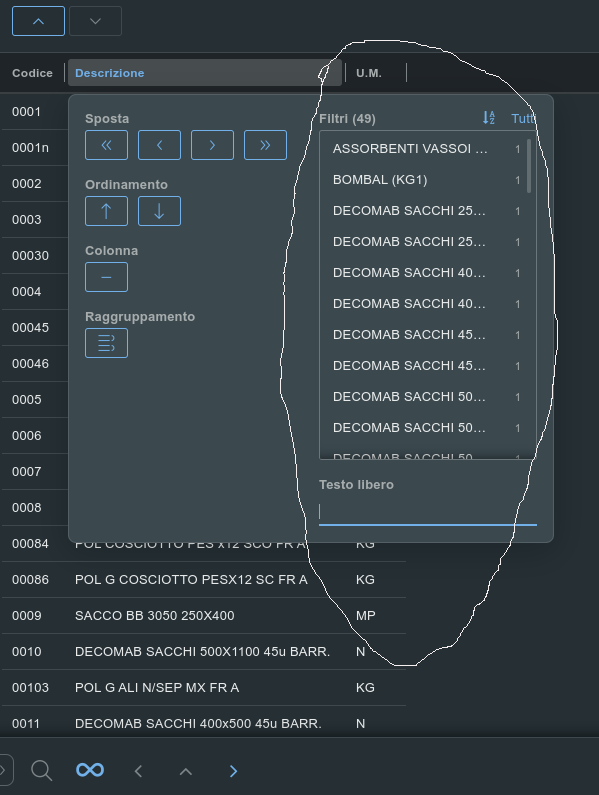

Good morning,
i think i solved all the problems for sorting and selecting.
Only the list of lines visible in the menu remains.
index.php/fa/42955/0/
Does anyone know if it's possible to substitute the source of the list list from the visible table to the result of a sql query?
