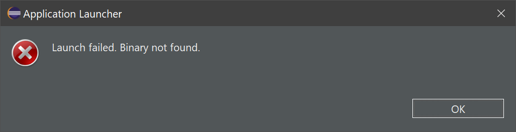

I want to run my compiled windows exe.
As a compiler I use the w64devkit 1.17.0 (MinGW-w64) added as a cross-gcc toolchain.
Compilation is successful and the exe file is in the Debug or Release folder.
But when I just press the Run button, I always get the error "Launch failed. Binary not found."

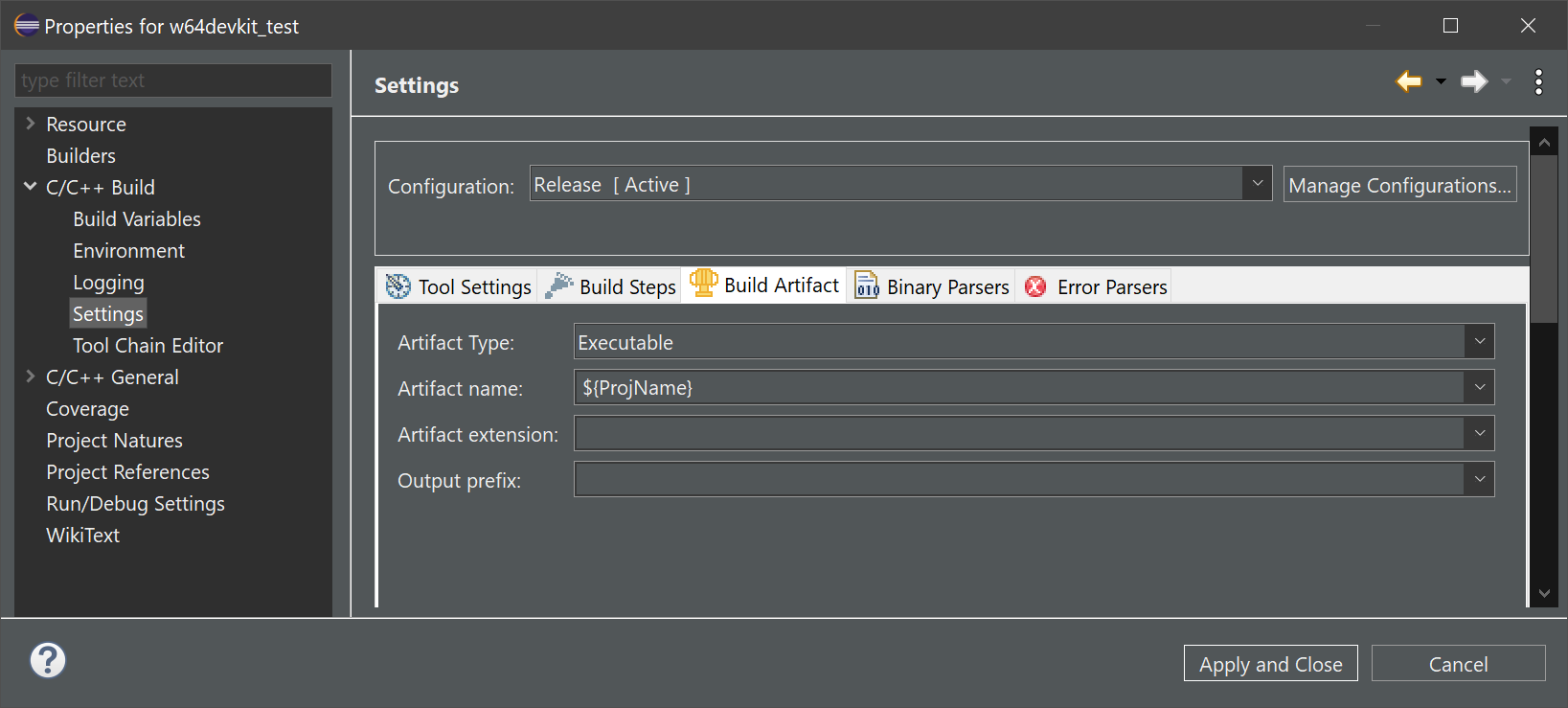

index.php/fa/42709/0/
I then created the run configuration manually and entered this as the application path:
${workspace_project_locations}\${config_name:${project_name}}/${project_name}.exe
That also works, but only as long as the exe file name is identical to the project name.

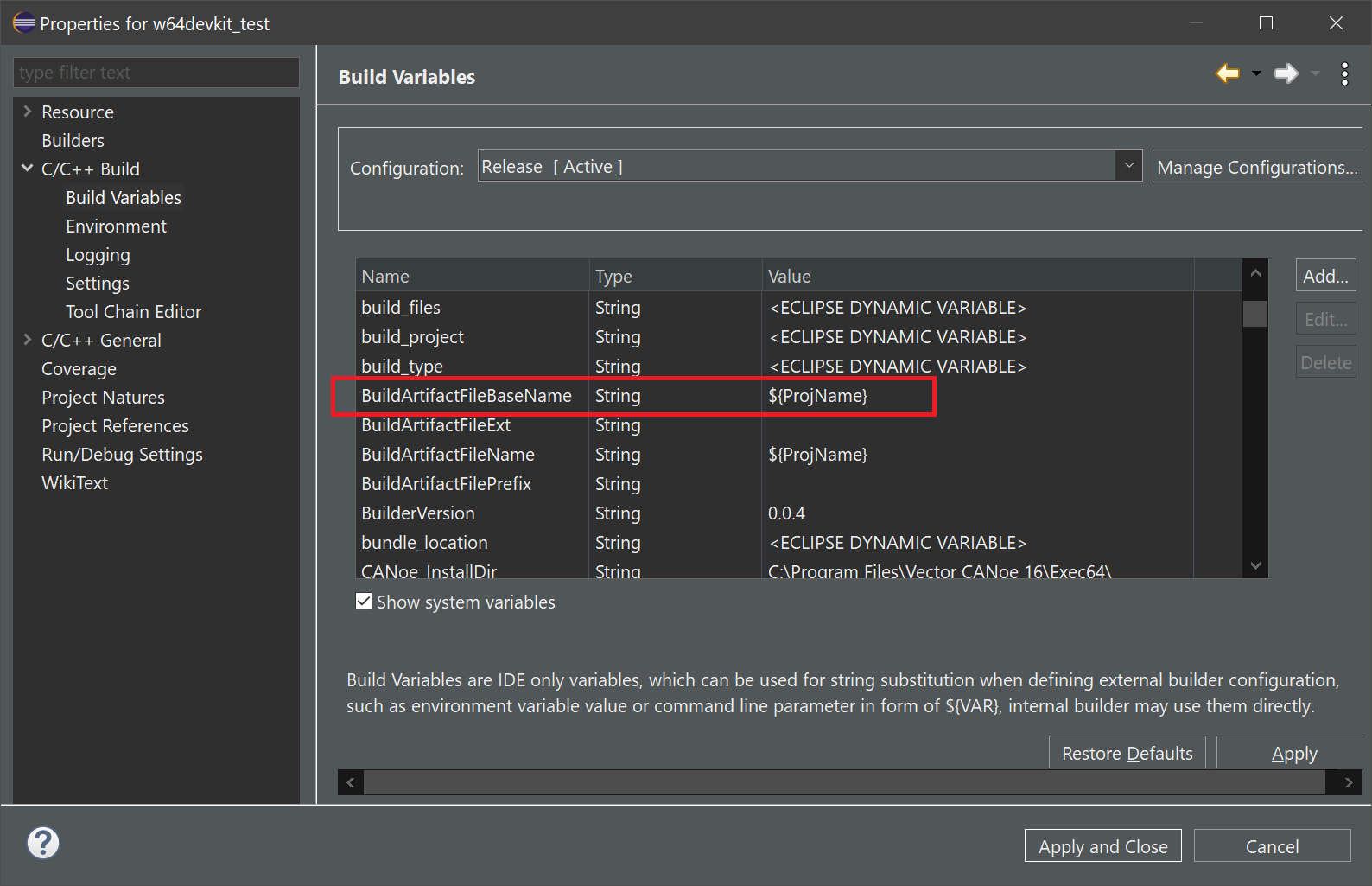

index.php/fa/42710/0/
Is there a possibility to use the build variable "BuildArtifactFileName" at this point?
