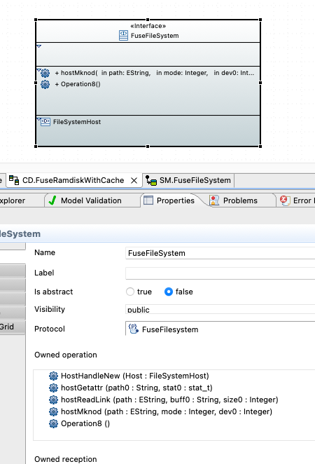

when I add operations to a Class and use the Properties dialog, the definitions do not appear in the visual representation of the Class on the diagram.
When I use the pallete to define an Operation the operation appears in the Class. (see diagram hostMknod)
I'm confused, seems faster to use the Properties dialog, yet, I can not see what magic 'bit' enables the operations to then appear in the Class definition.
a) is it possible to add a operation via the properties dialog and have it visually appear in the Class diagram?
:) how?

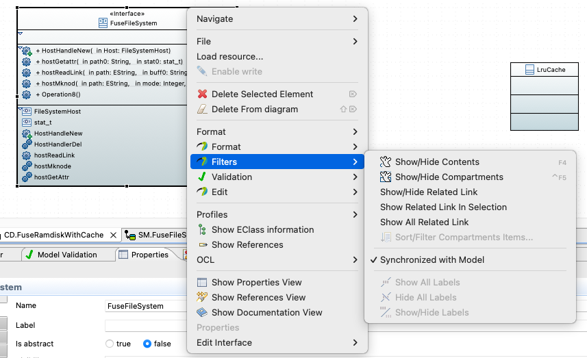

found the answer,
1) right-click on object
2) Filters | Synchronize
The operations in the properties window appear. Unselecting Synchronize and the operations remain visible.
Perhaps this is a bug?
Re: adding operations to a Class [message #1855240 is a reply to message #1855223] Mon, 03 October 2022 14:15 Go to previous message
Hi Sam,
no, this is intended behavior.
/Carsten
