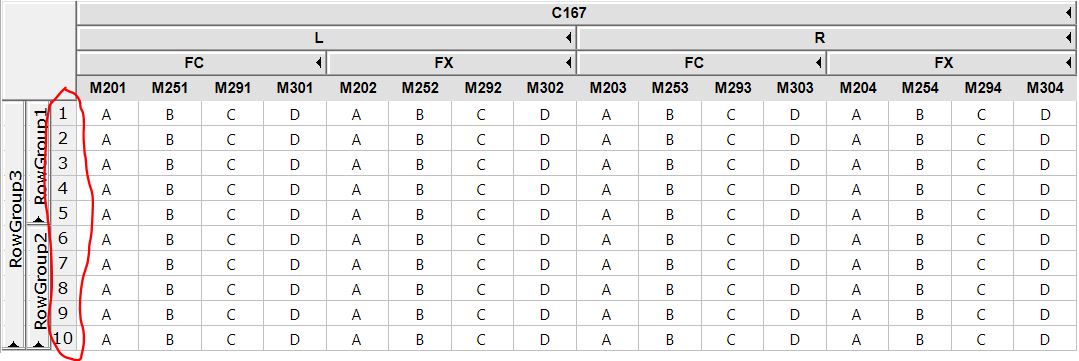

As per my requirement I need both column group header layer and row group header layer. Whenever I use row group header layer, the default row numbers are visible. Is there any possibility to hide or remove these row numbers?

Hi Dirk,
Please find the attachment. I want to hide those row numbers. If i use grid layer or composite layer with 2/2 dimension, these are visible.
I tried to set the row header width to 0 also. Still it is visible. Please find the code snippet below. Is there any possibility to hide to remove these row numbers.

Re: How to remove or hide default row numbers when using row group header layer in composite layer [message #1854570 is a reply to message #1854461] Thu, 25 August 2022 18:24 Go to previous messageGo to next message
.Probably it is not enough to change the default width. Try to set the width of column 0 to 0 explicitly:
rowHeaderDataLayer.setColumnWidthByPosition(0, 0);
Re: How to remove or hide default row numbers when using row group header layer in composite layer [message #1854577 is a reply to message #1854570] Fri, 26 August 2022 05:13 Go to previous messageGo to next message
After setting column width by position also, the row numbers are still visible only. Please let me know if there is any alternative to hide or remove these row numbers.
Re: How to remove or hide default row numbers when using row group header layer in composite layer [message #1854592 is a reply to message #1854577] Fri, 26 August 2022 17:40 Go to previous messageGo to next message
After looking closer your grouping configuration is incorrect. The grouping levels are 0 based, but you configure level 1 and 2, which means your level 0 is empty. Change your group configuration to start with level 0 and then 1 and it works.
Re: How to remove or hide default row numbers when using row group header layer in composite layer [message #1854603 is a reply to message #1854592] Sun, 28 August 2022 18:07 Go to previous message
Thank you for correcting the code. Now its worked. Thanks a lot for your time and response.
