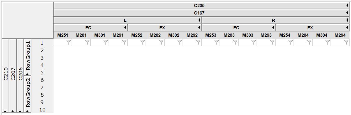

Hi Dirk,
Thank you for your response. As you told, I implemented with grid layer and Composite layer with 2/2 dimension also. Both are working fine as expected.
//With Grid layer
CompositeLayer compositeLayer = new CompositeLayer(1, 1);
compositeLayer.setChildLayer("Grid", gridLayer, 0, 0);
//With Composite Layer
CompositeLayer compositeLayer = new CompositeLayer(2, 2);
compositeLayer.setChildLayer(GridRegion.CORNER, cornerLayer, 0, 0);
compositeLayer.setChildLayer(GridRegion.COLUMN_HEADER, filterRowHeaderLayer, 1, 0);
compositeLayer.setChildLayer(GridRegion.ROW_HEADER, rowGroupHeaderLayer, 0, 1);
compositeLayer.setChildLayer(GridRegion.BODY, bodyLayerStack, 1, 1);
The output looks like as attached.
Now my question is, how to remove or hide default row numbers. I have checked your previous answers like to remove or hide row numbers, use Composite layer instead of Grid layer with column header and body layer.
But now in my requirement I need both column group header layer and row group header layer. whenever I use row group header layer, the default row numbers are visible. Is there any possibility to hide or remove these row numbers?
Thanks in Advance
Amaresh
