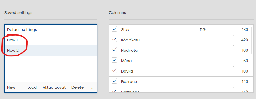

Is there a possibility to programmatically define "saved" settings for the table in Scout Classics? So that users can choose from the author's presets?
And is it possible to programmatically switch between these settings (e.g. after pressing a button)?
See image:

The table view settings are stored in the ClientUIPreferences. Have a look at the code in OrganizeColumnsForm.java, especially storeCurrentStateAsConfig() and ApplyMenu. The preference key is derived from the class name of the table and the name of the setting.
Technically, you should be able to initialize these settings programmatically, but the API is not very convenient. Also, you would have to prepare the settings for each user, and they would be able to manipulate your presets.
It might be easier to simply add some custom "Change view" menus to the table that programmatically sets the desired properties to the columns. Alternatively you could replace the entire OrganizeColumnForm by replacing the OrganizeColumnsFormProvider bean.
