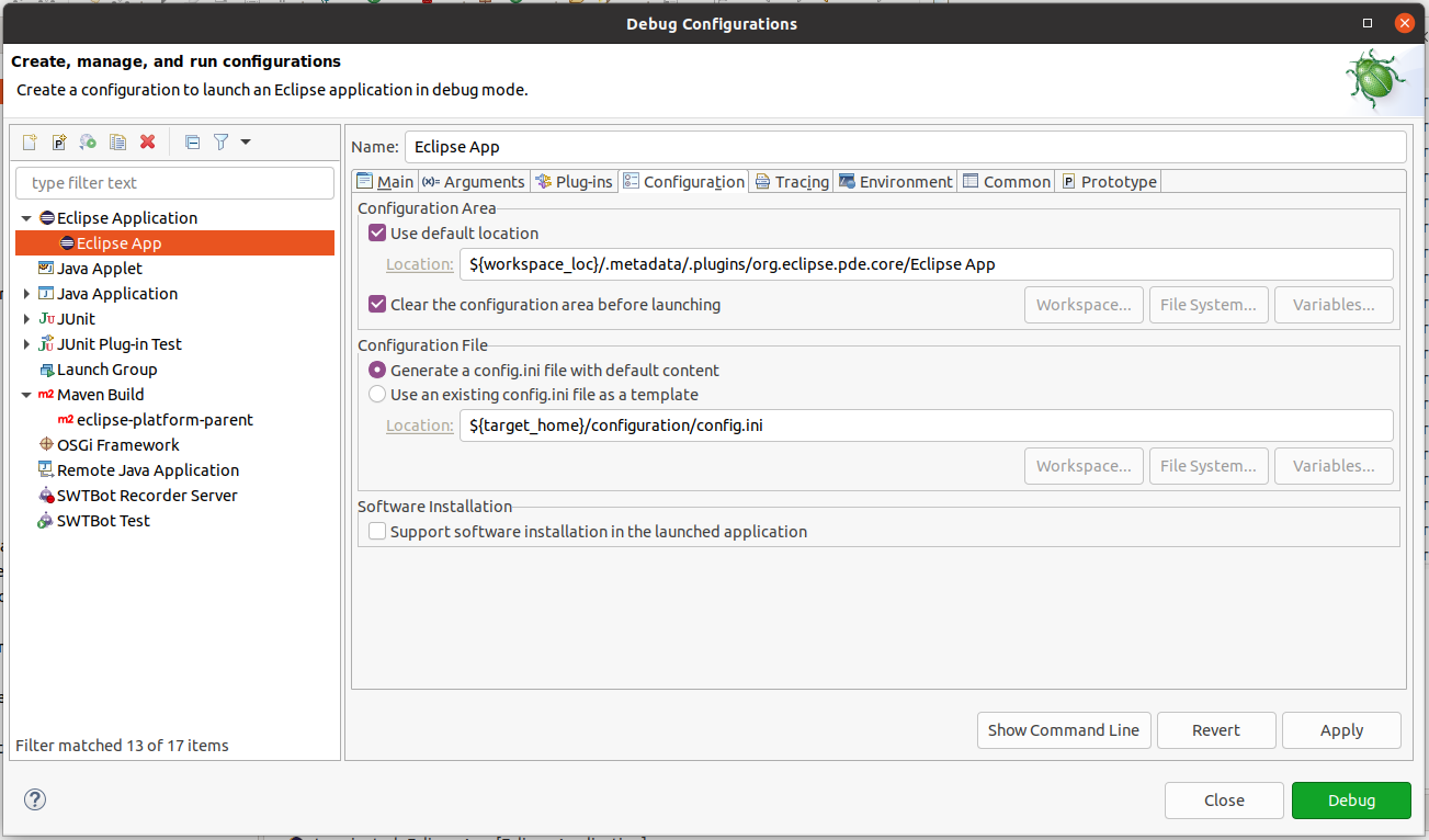

I added the screenshot where is visible that I add launcher as "Eclipse Application". I also try to play with "Run a product", try different applications from the combo box. But no difference. In top of screen visible that instead of stop on my breakpoint it stops in appropriate *.jar file.

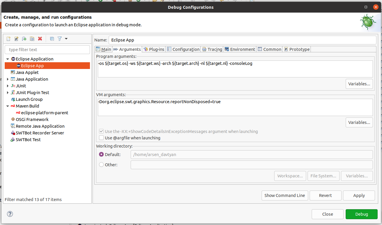

Below I also attached the other tabs of my launcher.

Sorry, I didn't see your picture the first time. It doesn't look like you really imported the projects as projects but rather imported the entire Maven folder as a single project. You won't be able to launch from that form.
Better you use the automated setup to create the development environment such that the projects are properly imported individually:
https://www.eclipse.org/setups/installer/?url=https://raw.githubusercontent.com/eclipse-jdt/eclipse.jdt/master/org.eclipse.jdt.releng/JDTConfiguration.setup&show=true

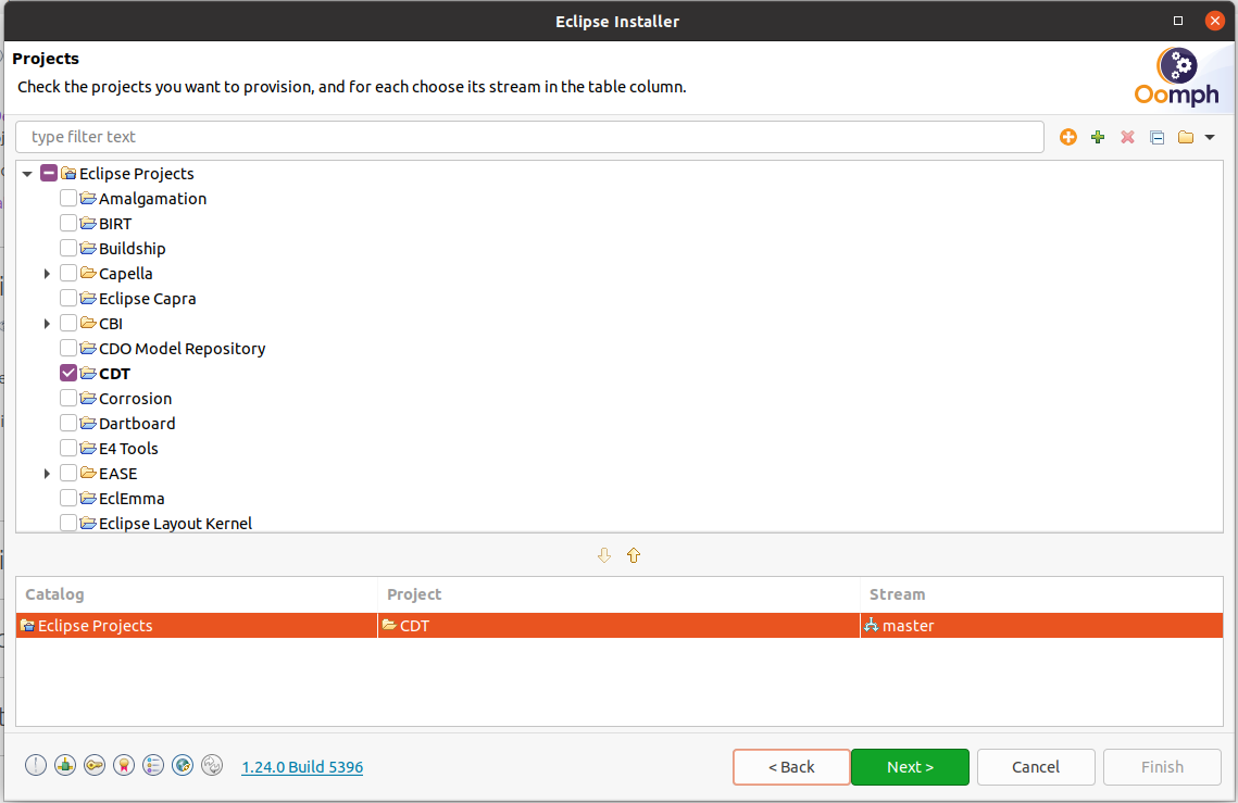

Dear Ed. Do you know the same place for CDT, where I can get sources and make my changes on the CDT itself, as I can do with JDT? Because I cant find the same place for CDT. And when I select CDT in installer manually/JDT checkboxes was checked automatically/ it gives error during installation.

Probably you had this error:
ERROR: org.eclipse.equinox.p2.director code=0 Missing requirement: artificial_root 1.0.0.v1659515430790 requires 'org.eclipse.equinox.p2.iu; org.eclipse.pde.api.tools.ee.feature.feature.group 0.0.0' but it could not be found
That feature has been removed in the 4.25 (2022-09) stream. CDT needs to remove it from their setup to fix this problem; I'll try to help fix it for them...
To avoid the problem for now, I suggest choosing the Committers product (not the Eclipse SDK product) and picking the 2022-06 version on the first page of the installer. That worked for me just now; mostly, I did have timeouts resolving the target platform and and to do Help -> Perform Setup Tasks... a second time to get it to work. Then I still have timeouts cloning https://git.eclipse.org/r/cdt/org.eclipse.cdt but I tried ssh://emerks@git.eclipse.org:29418/cdt/org.eclipse.cdt which finally worked, but you need to set up Gerrit for that:
https://wiki.eclipse.org/Gerrit

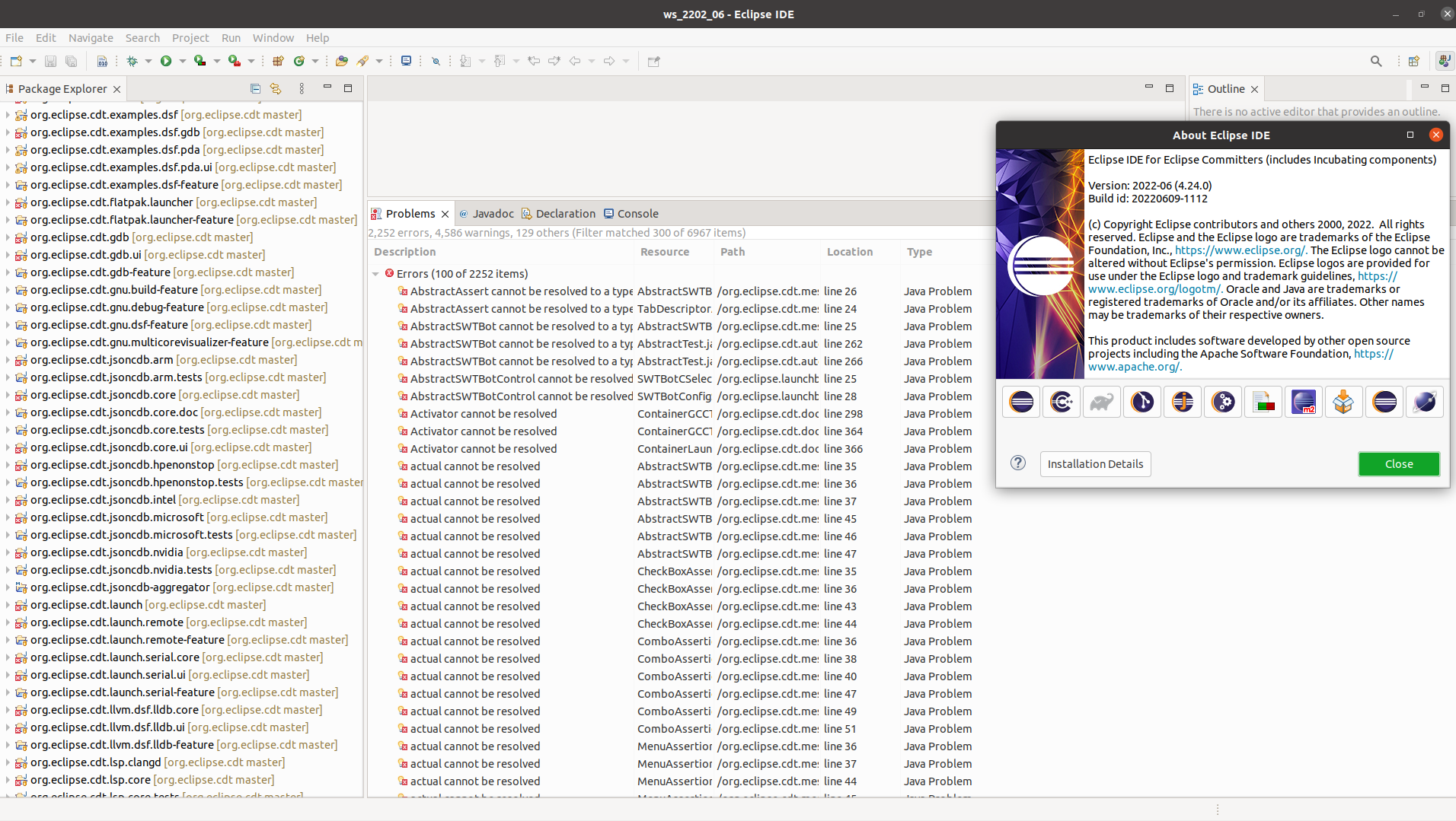

Dear Ed, I installed Commiters 2022-06 (before that was 2022-03) version as you suggested. I also have timeouts on cloning by https and I have some difficulties with Gerrit set up. As I have no bug to fix for CDT. I just want to investigate some rename dialog on CDT. By the way I always clone directly from command line git master branch (if I should take an other version please correct me).
But it gives me 2000+ errors

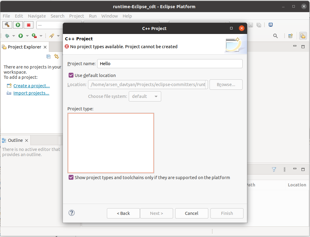

If I skip them all and try to run anyway. The target eclipse(CDT) does not allow to create some project.
index.php/fa/42374/0/

The setups are there to eliminate the "sea of red" that you typically get from just cloning and just importing projects and hoping for the best. BTW, I opened this bug to contribute fixes to the CDT.setup, but they are in the processing migrating the project to github:
https://bugs.eclipse.org/bugs/show_bug.cgi?id=580505
