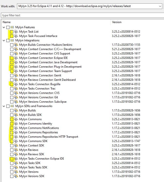

Hello, I never use the "upgrade" method. I always do a fresh installation of the Eclipse IDE for Eclipse Committer.
in the version 2022-06, I don't have the Task List View, and this feature is not proposed by the the default udpate site 2022-06-https://download.eclipse.org/releases/2022-06/. It was still available in 2022-03.
I resolved the problem installing (too?!) many thing from the update site http://download.eclipse.org/mylyn/releases/latest
index.php/fa/42382/0/
