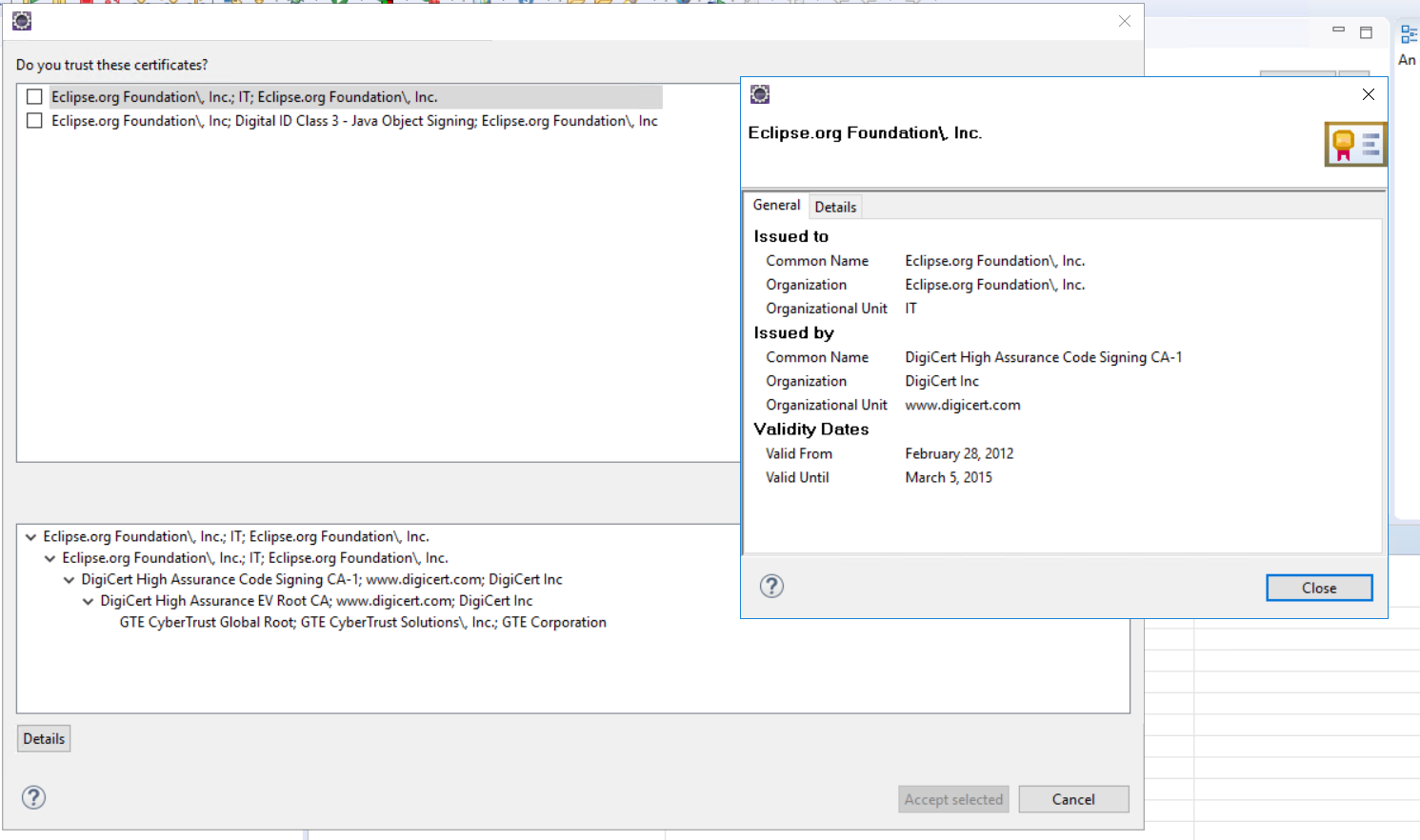

I have registered a bug regarding a bad certificate on an eclipse server.
The issue has not been picked up.
This is issue is preventing our dev team from updating eclipse packages because our proxy servers reject expired certificates.
https://bugs.eclipse.org/bugs/show_bug.cgi?id=580301
Did I report this issue to the correct location?
Thank you
index.php/fa/42281/0/

You didn't provide information such as which version of GMF you are trying to install or update.
All certificates do expire. But an old signed jar that was signed by an old certificate that was valid at the time the jar was signed is still valid today. It's just that at some point the root of that certificate itself is no longer in the cacerts of a modern JRE so you see that dialog come up. Newer versions of that dialog clearly indicate which plugins/artifacts are involved which this older version of the dialog does not.
If you look at this generate reports you'll see that most of the certificates being used for the most recent release are now expired:
https://download.eclipse.org/oomph/archive/reports/download.eclipse.org/releases/2022-06/202206151000/index.html
It's probably this artifact that is signed by the certificate you show:
https://download.eclipse.org/oomph/archive/reports/download.eclipse.org/releases/2022-06/202206151000/index/com.sun.el_2.2.0.v201303151357.html
And this is probably the other one:
https://download.eclipse.org/oomph/archive/reports/download.eclipse.org/releases/2022-06/202206151000/index/javax.servlet.jsp_2.2.0.v201112011158.html
Neither of these are produced by GMF so they can't fix it. These appear to be produced by Orbit:
https://projects.eclipse.org/projects/tools.orbit
