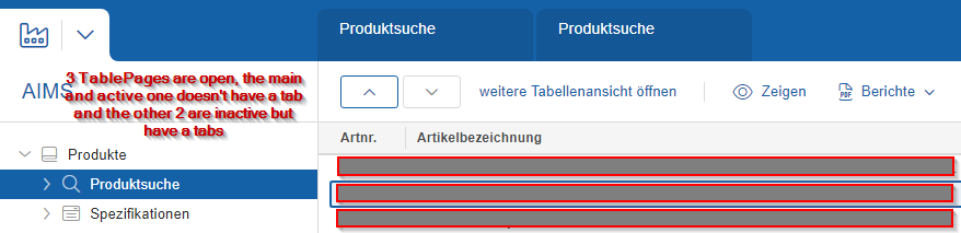

in our application we are working with several PageWithTables to find an navigate within our data. If you for example want so search for 2 groups of data to compare something you can't do that within one table page.
I was trying to open a PageWithTable a second time but I think this is not possible due to the concept of Outline/Pages, correct?
But I found an older thread referring to the AbstractPageField and tried it. It might confuse the user because then you have 1 table page without a "Tab" and several table pages with a "Tab" but apart from that it works well.
index.php/fa/42192/0/
Is it a good idea to use it like I did? Is there another way to do it?
We are opening other forms e.g. to edit the data from the tablePages (the main one and the pageForm ones).
Or would it be better not to use the PageWithTable for this use case at all and reimplement the Table/SearchForm/DetailForm-logic in an ordinary form and open it multiple times?

Re: Open PageWithTable several times [message #1856397 is a reply to message #1853016] Thu, 08 December 2022 07:47 Go to previous message
Yes, this is not part of the concept.
I see the following possibilities:
  • Open all pages as views with a page field. However, this would be less comfortable to use and you loose the ability to drill-down.
  • Dynamically add new instances of the table page to the outline tree, e.g. using a menu. Depending on the exact use case, this is probably the best option.
  • Let the users open multiple instances of the application in multiple browser tabs. (Only works for few tabs, because of the browser's per-host connection limit.)
