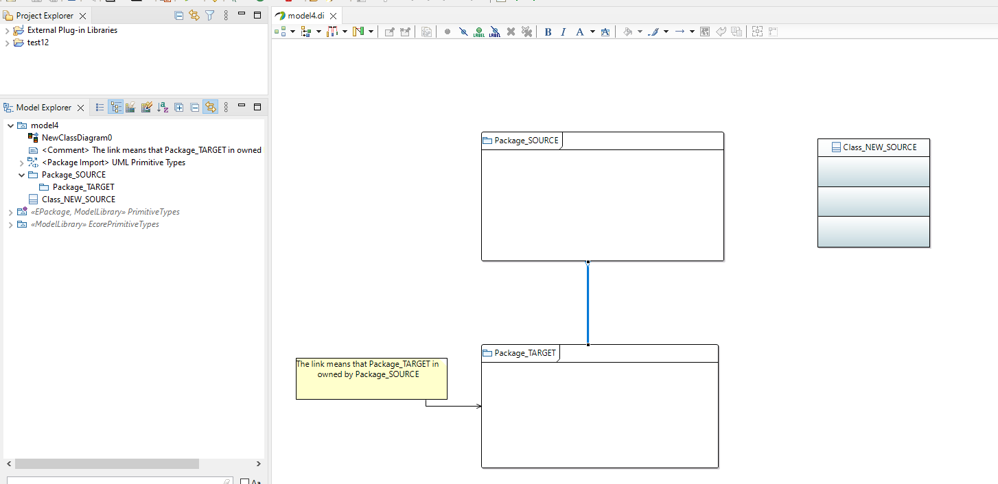

I'm developing a Reconnect tool for the UML ContainmentLink in a Sirius based UML ClassDiagram for Papyrus). I would like to write a precondition to be able to check the enablement of the tool.
index.php/fa/42190/0/
On the previous image, the link means that Package_TARGET is owned by Package_SOURCE.
I want to create a precondition to forbid the reconnection on the source side from Package_SOURCE to Class_SOURCE, because a such containment is forbidden (Class_SOURCE can't contain Package_TARGET).
