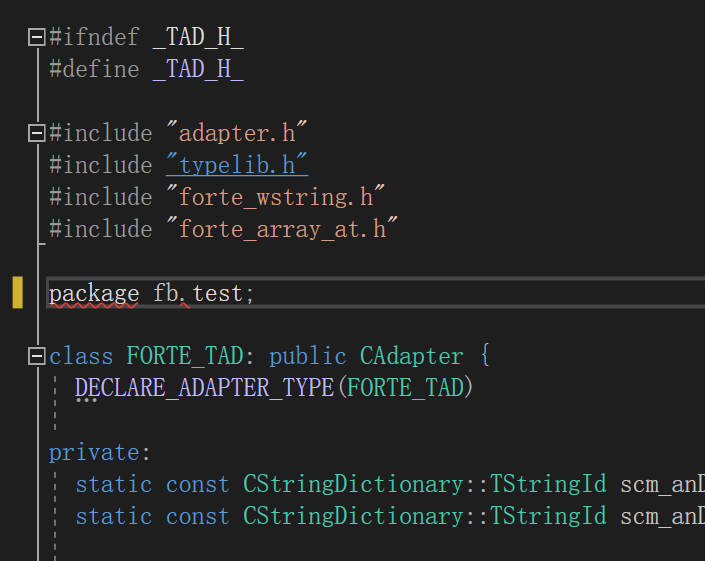

As I exported my custom FB Adapter(TAD), the wrong code 'package fb.test;' appeared

Have you developed this adapter with FBDK, or did you create it in 4diac IDE? If it is the later we have to fix the adapter template.
To fix your problem you need to remove the text in the Header part of the Compiler Info. You can do this is the Type Info property sheet when your have your adapter open in the editor.
I hope this helps.

Hello, I created this Adapter FB in 4diac IDE and exported it to complie, then I found this problem. Thanks
