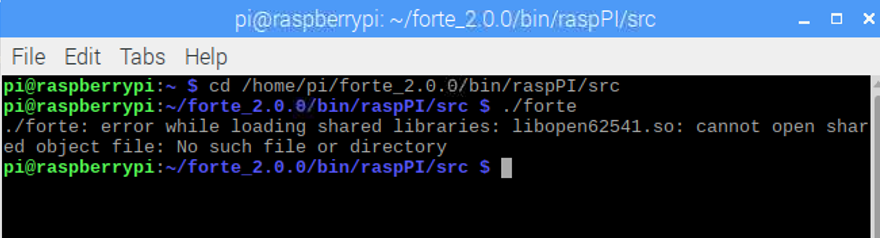

I've cross-compile FORTE to raspberry PI from my machine (Windows 11), and it works fine with the default FBs and even with my own FBs.
When I add the open62541 library compilation of FORTE also ok. I've copy the libopen62541.so file (generate when compiling the library) to the same diretory with forte. But when I try to execute forte on rasp I got the below error:
./forte: error while loading shared libraries: libopen62541.so: cannot open shared object file: No such file or directory
see pic attached
Does anyone faced a similar issue?
BR.
Ricardo

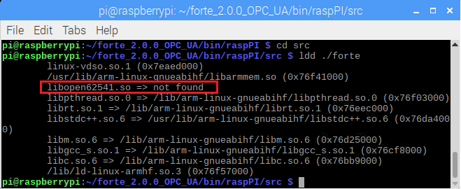

Hi Ricardo,
you could try a few things to find out more. First you can use ldd ./forte to check what libraries 4diac FORTE is expecting. Maybe there is some absolute path or something else strange. Also you could check with file libopen62541.so for which architecture your .so is compiled. Also you can have a look with ls -al in the directory where your 4diac FORTE executable is located if the .so is a symbolic link or not. I hope this gives you more insights to find out what is worng here.

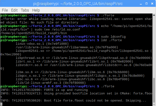

Hi Alois and 4diac community
I managed to run OPC. As Alois suggest it was a matter to link the libopen62541.so library to the path, which is the directory with the all compiled OPC-UA files.
Running the command $ ldd ./forte we can see that the path is missing.
index.php/fa/42082/0/
By running the /etc/ld.so.conf command and than run ldconfig the path is set permanently to the libopen62541.so.
$ echo "/home/pi/open62541/build_raspPi/bin" | sudo tee /etc/ld.so.conf
$ sudo ldconfig
$ ldd ./forte
index.php/fa/42081/0/
Note that at Linux it is note necessary to save the libopen62541.so at the same directory as forte executable, as I stated before.
Hope that may help other fellows in the community.
B.R.
Ricardo
