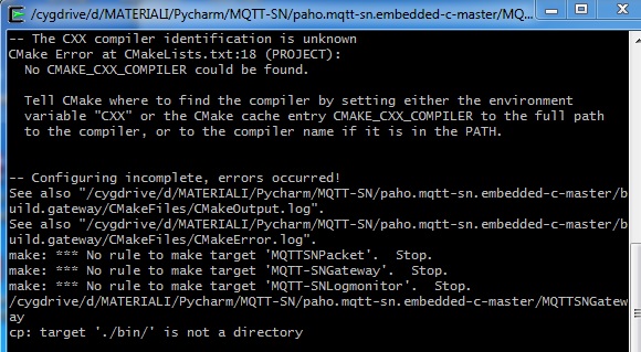

Hi, i try to run this project on PC Win 7, via CygWin, but got this error. Any help ?
https://github.com/eclipse/paho.mqtt-sn.embedded-c
index.php/fa/41607/0/

Your Cmake is not happy as it has not found the C++ compiler on the computer. Did you install the C++ compiler (GNU g++) on Cygwin?

Did you read the error message on the posted screen?
You need to add the path to the compiler to the system PATH given to Cygwin or set the CMake variables as told.
