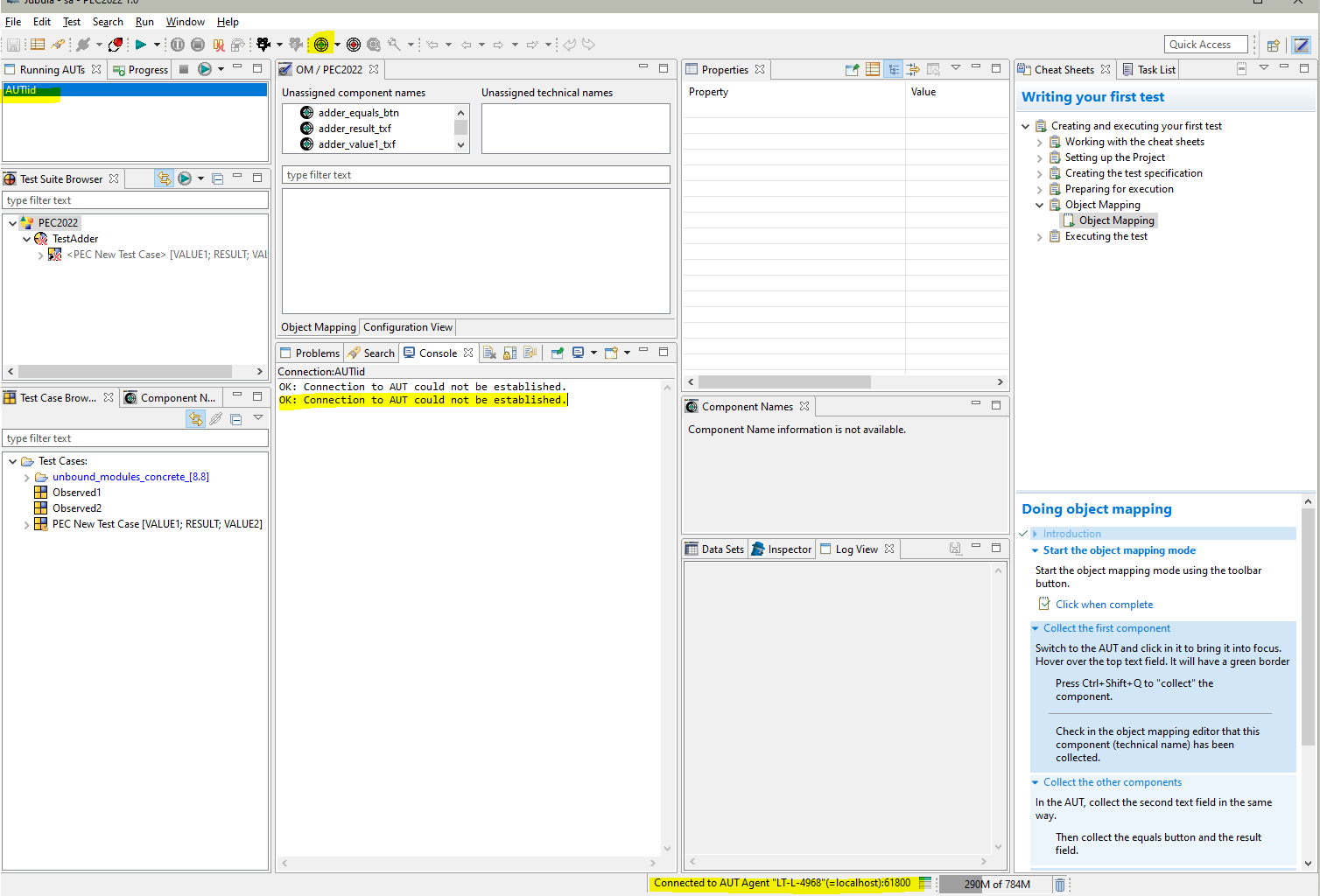

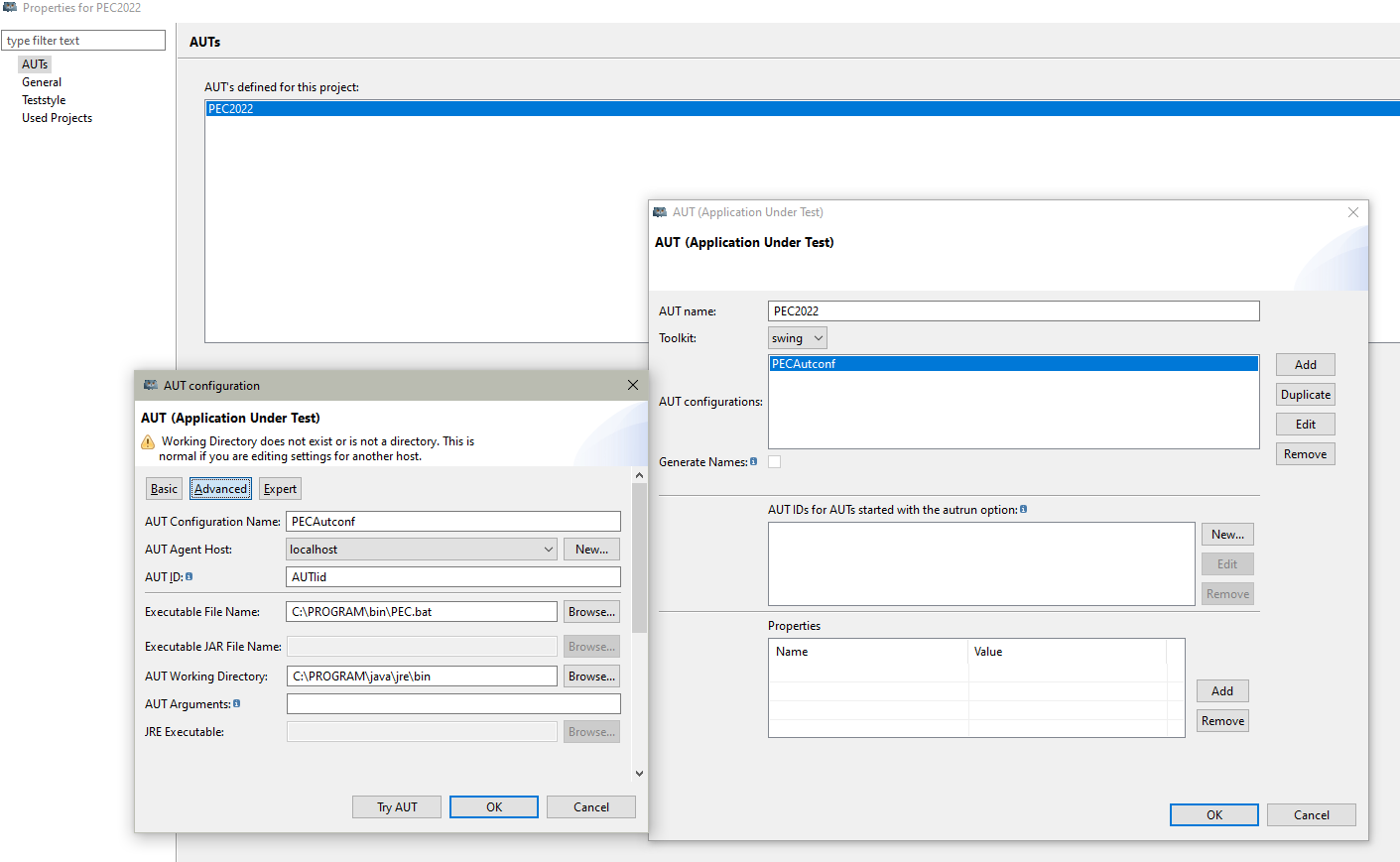

i have a Windows swing java program (that use Eclipse Adoptium Temurin-11.0.13+8 JDK) , that i need to test, and i can start it from Jubula AUT (local or embedded) without issues. The problem is that when i click on "Start object mapping Mode" in Jubula I instantly get an error:
2022-01-26 15:36:27.160 [Awaiting command: class org.eclipse.jubula.client.internal.commands.ConnectToAutResponseCommand] WARN o.e.j.c.i.c.ConnectToAutResponseCommand - org.eclipse.jubula.client.internal.commands.ConnectToAutResponseCommandtimeout() called
2022-01-26 15:36:37.127 [Worker-127: Start Object Mapping Mode] ERROR o.e.j.c.c.c.AUTConnection - Connection to AUT could not be established.
If i start mapping from local AUT icon - then mapping works, i can get object name but full object details is not appearing in Jubula Test case Object Editor, so it is kind of useless.
I have tried to start AUT with autagent.exe -om option but it makes no difference.
Adder example object mapping works fine, so it must be something with my program, any thoughts?
My program has many start parameters that rings no bell to me, maybe i can change something here to make mapping work?

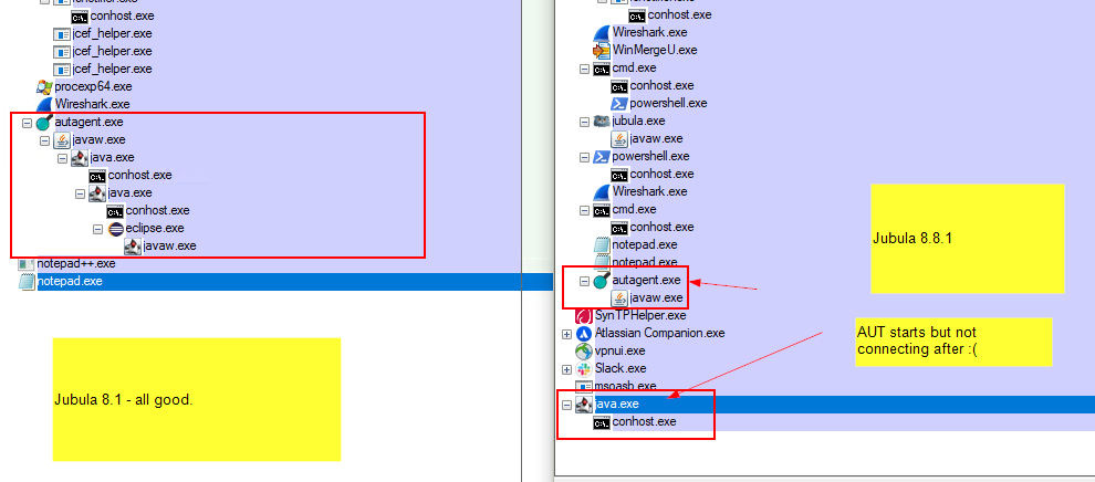

I have noticed that on Jubula 8.8.1 application starts on a new thread while on 8.1 it starts under parent AUT thread. Could this be the reason why AUT is not connecting?
