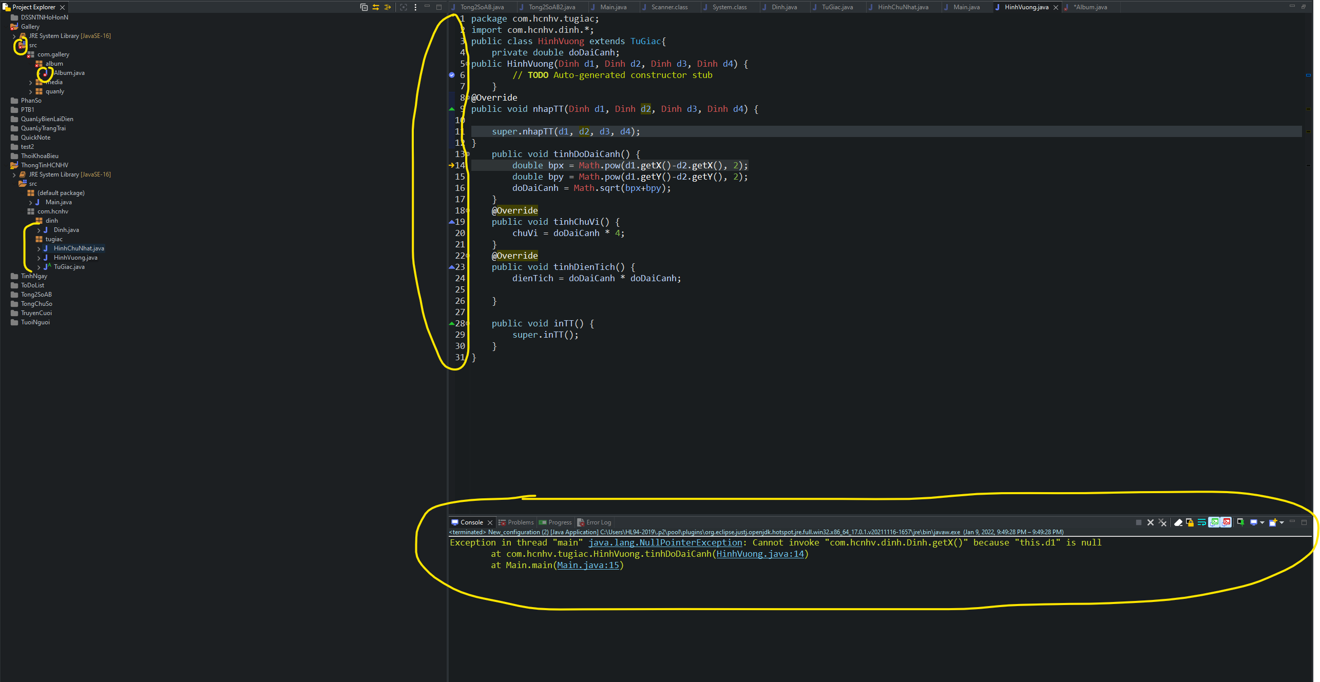

I'm new to Java, I'm using Java Eclipse. Normally it will show the error in my code (the red bulb) but this time it doesn't. But the code still can't run.
As you can see in the photo, there is no red x (like in the upper project) but my code still can't run
I think I know what is wrong with my code and how to fix it. I just want to know why Eclipse doesn't show the small red bulb like every other time?

You have a null pointer exception so there is a bug in your code. You'll need to fix it. That's unrelated to errors where the code doesn't compile.
