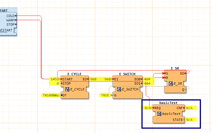

In Step 4 - Create Your own Function Block Types at https://www.eclipse.org/4diac/en_help.php?helppage=html/4diacIDE/createOwnTypes.html#createBasic, I create basicTest FB according to "Create a Basic Function Block" , but I don't know how to get this FB running.
Is there any supplementary material to tell me how to make the "STATE" of basicTest node have value output?I get all "NA" now
Thanks

Have you also performed the C++ export step and built your own 4diac FORTE containing your own basic FB as described at the end of the tutorial? If yes have you started your ow built 4diac FORTE or the one you downloaded? Did you get any errors in the deployment console.
