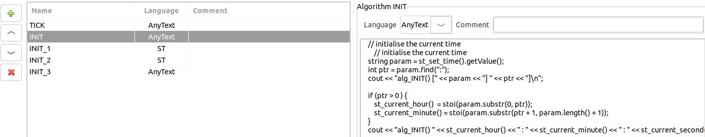

I checked the Menu-Bar menu but unfortunately that seems to be linked to the Algorithm list on the left in the picture I attached. Selecting text in the Algorithm window and then copy/paste from the menu just created new Algorithm entries in the list. Could I please log that as a bug?

I found a simple work-around. I created my new algorithm in an open Linux Text Editor window and was able to paste it in. It appears that once it is in the Linux clipboard buffer, you can then paste it into the algorithm window. You just can't select and copy text already in the Algorithm window at the moment.
