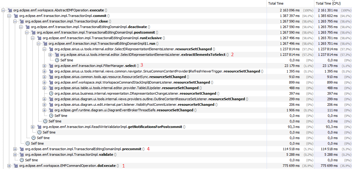

We have a model operation which creates 10-100 thousands of objects. It seems that SelectDRepresentationElementsListener tries to handle this resource change and to select added elements in a table representation.
The problem is that it takes a lot of time:
index.php/fa/41291/0/
1 - our operation, it works long enough but it's not a problem because a user can see a progress and can cancel the operation
2 - Sirius tries to select changed objects in a table. It takes too much time. And a user can't even cancel it
3 - I guess that Sirius checks here whether representations for deleted objects should be closed
4 - I guess that it's dangling references deletion, etc.
The main problem is 2. Here is SelectDRepresentationElementsListener::resourceSetChanged()

It finds elements to select, this operation takes a lot of time. And after that it checks whether the editor is active and selects the elements. But our editor is not even active, it's just opened. Another editor is active. Maybe it's possible to extract elements after active editor check?
Is it possible to disable element selection? We don't need to select 100 thousands objects :)
Maybe it's possible to optimize the following method called from extractElementsToSelect():

Elements are not selected in the inactive editor. But method SelectDRepresentationElementsListener::resourceSetChanged() calls extractElementsToSelect() at first (the call takes a lot of time) and only after that it checks whether the editor is active. And if it is active, then it calls SetSelectionRunnable(). So it doesn't matter active editor or not (will elements be selected or not), the slow method extractElementsToSelect() is called anyway. And this method blocks UI for a long time.
We don't define a creation tool to run this operation, so we can't set "Elements to Select". This operation runs a discrete event simulation (DES) for a process model. We have 2 table representations: 1) input parameters for DES 2) execution log for DES (this table contains 10-100 thousands of objects after DES is finished).
The operation is implemented in QVTo. And we run it using a custom toolbar button executing org.eclipse.emf.transaction.RecordingCommand. Replacing it by AbstractCommand with undo disabled doesn't speed up things. In other words it's an external to Sirius command. Maybe we should call it differently?..
