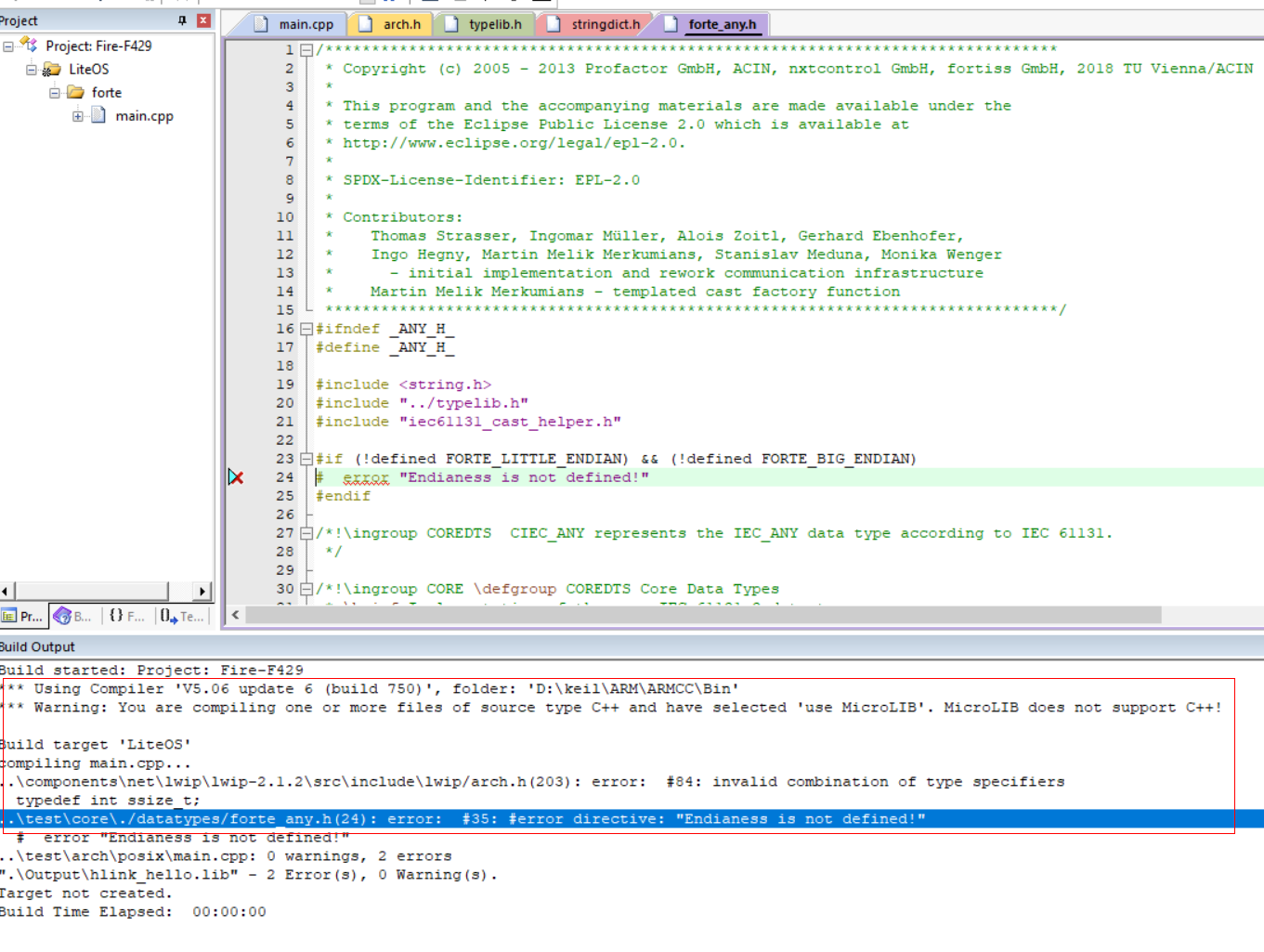

I'm building Eclipse Forte Code in keil uVision5 now, but compiler point out "MicroLIB does not support C++"
I'm worried about whether this information must be solved,
Have any friends successfully met and solved this problem

I see here to issues. First of all you are not using CMake for setting up the FORTE build. this results in the endianess detection issue.
Second you need a toolchain that supports C++. 4diac FORTE is written in C++ and requires toolchains that support C++ compilation.

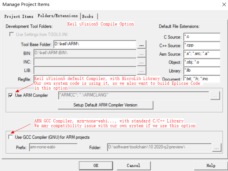

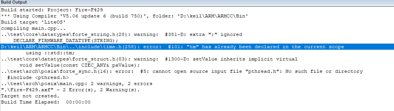

Could you please build 4 DIAC FORTE with keil uVision5 software on your local machine?
For many MCU device such as STM32, we are in the habit of using keil software to compile projects.
If 4 DIAC FORTE can also build on keil, it will be great.
Attached picture is the problem what we are seeing, it is hard to go through with keil but we still want to achieve

My main machine is a Linux machine therefore I have a hard time trying uVision. However I googled a bit. Here I found an explanation what oyu need to do to setup a CMake toolchain file for Keil: https://community.arm.com/support-forums/f/keil-forum/44208/using-arm-toolchain-in-cmake/160363#160363
With that it should be possible to compile 4diac FORTE into a lib that you can then link to your Keil application.
I hope this helps.
