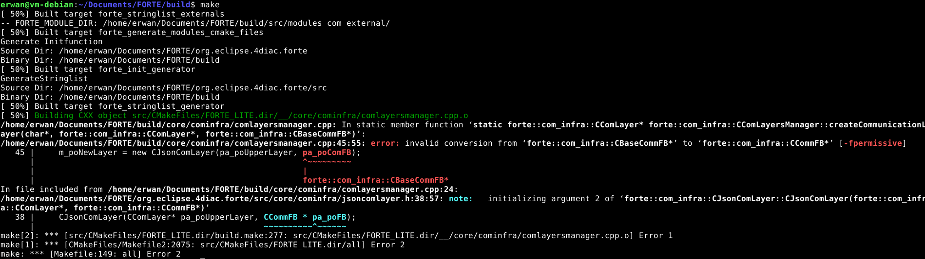

I have done some tests using several protocols and I am facing a difficulty to deserialize a JSON stream coming from a MQTT topic.
I found in a previous topic a solution providing a "Patch" but unfortunately I can't compile the code, probably due to a code evolution since its development.
Link : https://www.eclipse.org/forums/index.php/t/1084514/
Attached screenshot of compile error
I guess I'm not the only one since to have been confronted to this problem and I'm turning to you for help on this subject
Re: Deserialize a json message from an mqtt topic [message #1847422 is a reply to message #1847409] Tue, 26 October 2021 15:09 Go to previous message
I haven't looked into the JSon Layer in detail but I think if you replace all CComFB in jsoncomlayer.h and .cpp with CBaseCommFB you should be fine.
