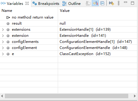

I put a breakpoint on ResourceSetFactory.java:77, and debug as Eclipse Application.
The attached picture shows the information in the Variables column.
index.php/fa/41204/0/
The detailed information of e is:
java.lang.ClassCastException: class org.eclipse.sirius.common.xtext.internal.XtextResourceSetFactory cannot be cast to class org.eclipse.sirius.common.tools.api.resource.ResourceSetFactory (org.eclipse.sirius.common.xtext.internal.XtextResourceSetFactory is in unnamed module of loader org.eclipse.osgi.internal.loader.EquinoxClassLoader @4587c8ff; org.eclipse.sirius.common.tools.api.resource.ResourceSetFactory is in unnamed module of loader org.eclipse.osgi.internal.loader.EquinoxClassLoader @4c844b27)
