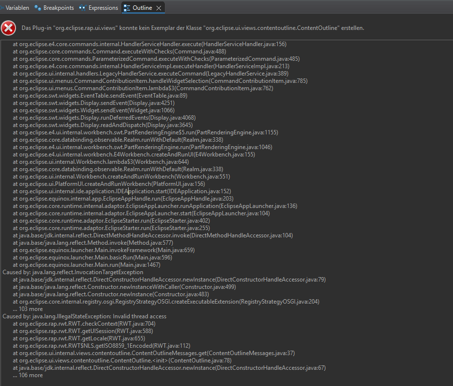

When I try to open keyboard shortcuts with Window . preferences - General - Keys it shows error: "Invalid thread access" .
Eclipse IDE for Enterprise Java and Web Developers (includes Incubating components)
Version: 2021-03 (4.19.0)
Build id: 20210312-0638
OS: Windows 10, v.10.0, x86_64 / win32
Java version: 11.0.5
Is there a possible fix for this issue?
Thank you!

no, I have not, this release is what we use standard.
Actually I think it was working after setting up Eclipse, but the problem appeard after I installed a language pack.
If it helps I found this stack trace in the problems tab:
java.lang.IllegalStateException: Conflicting handlers: {[org.eclipse.ui.internal.handlers.NewEditorHandler, for 'org.eclipse.ui.window.newEditor', in WorkbenchContext, active=true, sourcePriority=0, participating=true]} vs {[org.eclipse.ui.internal.handlers.NewEditorHandler, for 'org.eclipse.ui.window.newEditor', in WorkbenchContext, active=true, sourcePriority=0, participating=true]} in: org.eclipse.ui.contexts.dialog

I don't think an IDE should have rwt installed; it conflicts with swt. I don't even expect the RAP tools to be installed in the JEE package. It looks like something else that doesn't work well was installed in your IDE.
