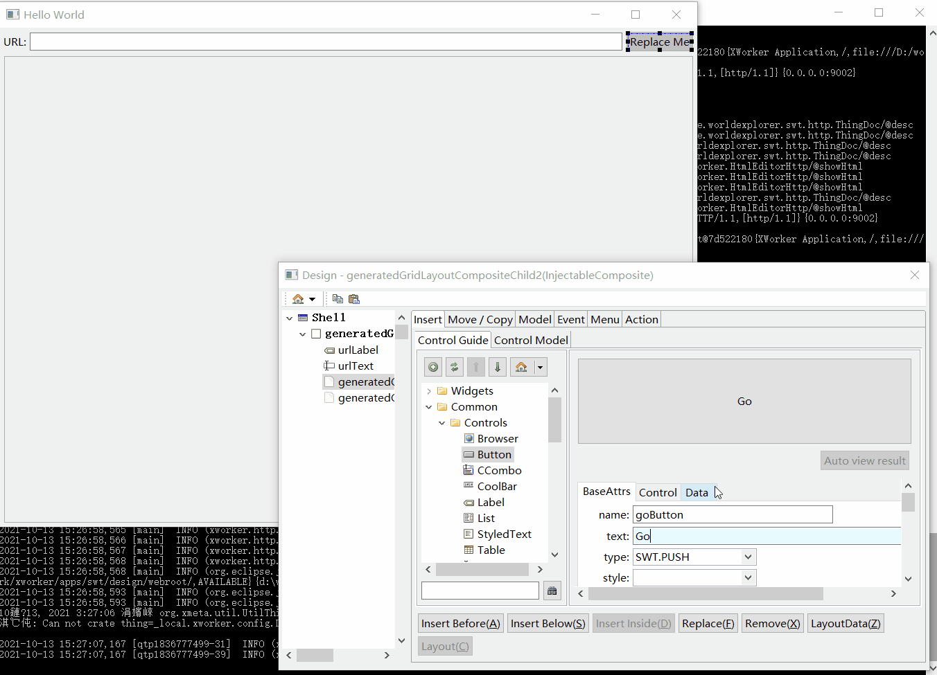

The dynamic model is a programming method that can realize real-time programming . XWorker is a development platform and model library for dynamic models. The dynamic model and XWorker are open source.
XWorker packages SWT into a model, and SWT-based applications can be developed through the model. The IDE for dynamic models is also developed using SWT.I hope those who are interested can take a look.

GIF video shows real-time design examples. Unlike other interface designers, you can also modify the running SWT interface written using the model.
https://www.xworker.org/files/2021/1013/170713design_replace.gif
