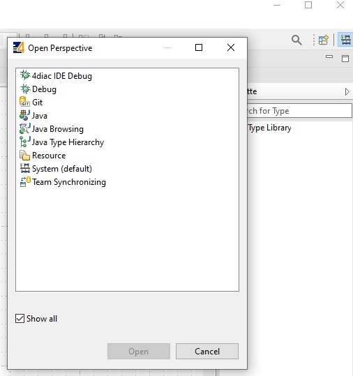

When using the 4diac version 1.14 found on the download page, there is no Deployment perspective.
I have tried on both Linux and Windows, same result. No deployment perspective.

We dropped the deployment perspective in the 1.14. release. Unfortunately we haven't found time to update the documentation yet. To much to do. Sorry for that. You can now deploy via the run menu or via context menu. Running simulated devices can be done via the simulated device manager which you find in the debug menu.
